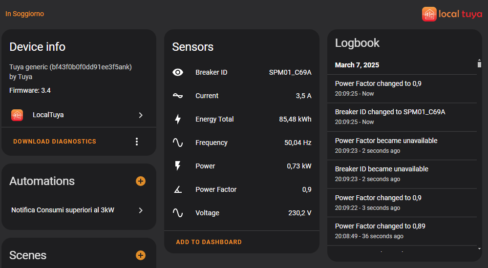

Hi everyone, I have a Zemismart SPM01-D2TW-ZM Wifi smart meter and a LocalTuya integration to read its values. However, I realized that it is not possible to use the Energy variable for statistics and for the energy dashboard, since the aforementioned variable does not have the 'state class’ attribute.
I also tried to edit via the ‘Developer tools’ page by modifying the ‘State attributes’ by inserting the new attribute. At the end of the operation I can see the new attribute in the sensor properties, but after a few second after SET STATE losing changes.
Does anyone know how to do it?
