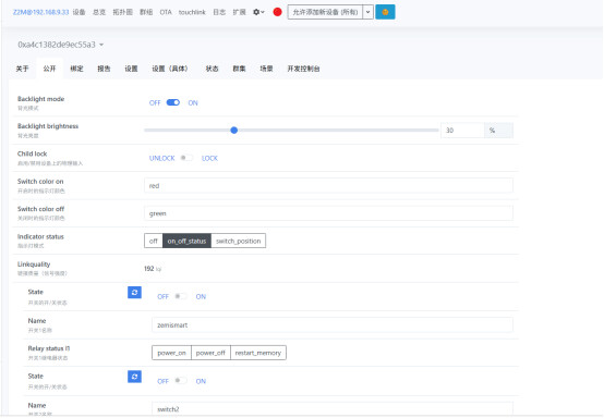

  5. Open the ZMS-206 device page and check whether the expected exposes/entities appear.

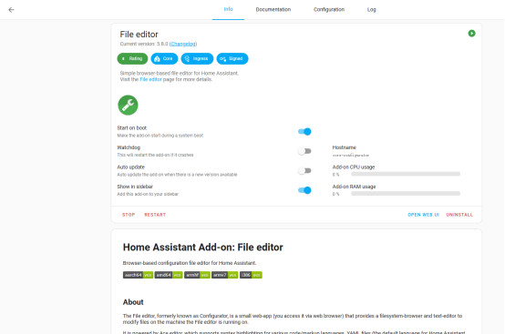

1. Open File Editor
In current Home Assistant versions, this may be under Settings -> Apps or App Store. In older versions, it may appear as Supervisor -> Add-on Store.
  1. Search for File editor.
  2. Install and start it if you do not already have it.

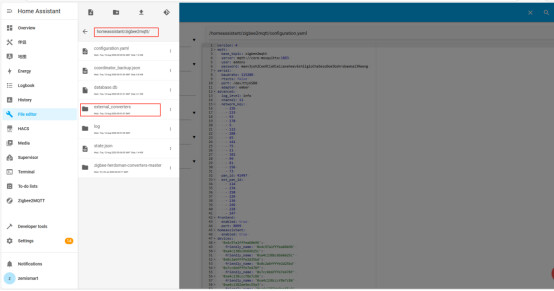

2. Create the external_converters folder
  1. Open File Editor.
  2. Go to your Zigbee2MQTT configuration folder.

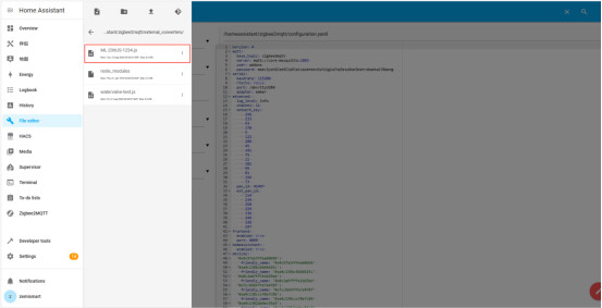

    • Home Assistant add-on setups commonly use: homeassistant/zigbee2mqtt/
    • The important point is that the folder should be next to the Zigbee2MQTT configuration.yaml file.
  3. Create a folder named exactly:
external_converters
3. Upload the converter file
Upload the ZMS-206 converter .js file into the external_converters folder.
For example:
homeassistant/zigbee2mqtt/external_converters/zms-206.js

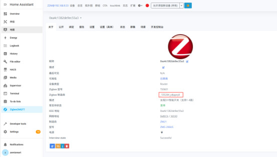

  3. Open the ZMS-206 device page.
  4. Check whether the expected exposes/entities are shown.
  5. If the exposes are missing, try re-interviewing the device.
