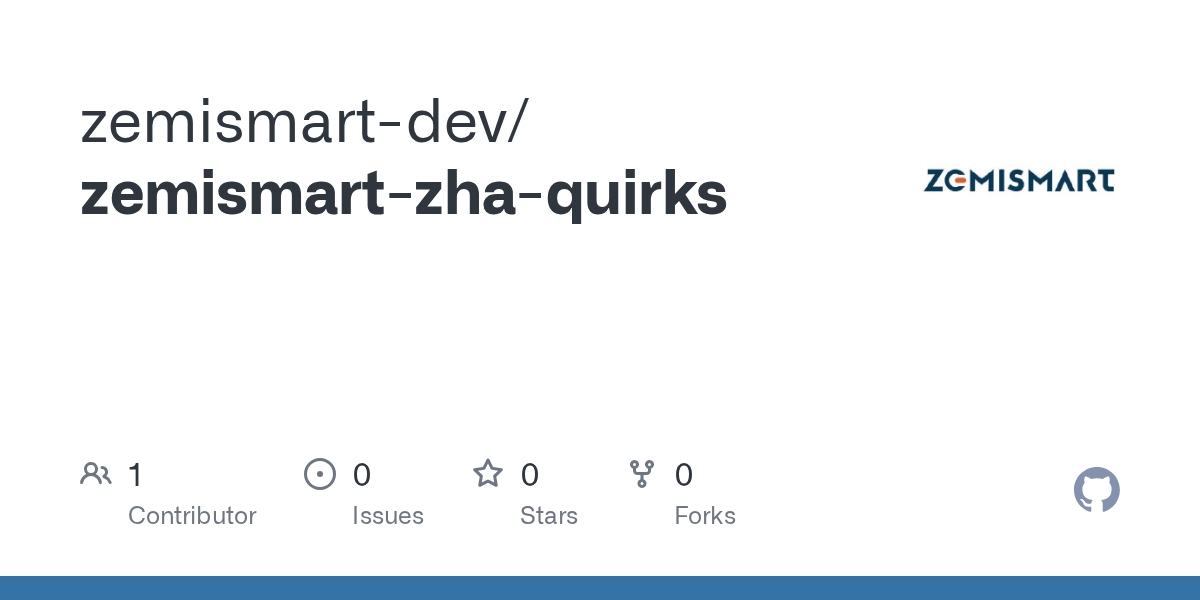

Installation (Recommended via GitHub)
You can install the updated quirk directly from our GitHub repository:
:backhand_index_pointing_right: GitHub Repository:
