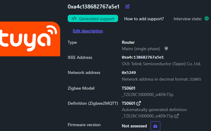

You’re right, the linked switch looked different, but the converter worked when I changed the fingerprint to _TZE28C1000000_o409r73p.

Hi, thank you for testing and confirming this.
We have verified that the converter works with the ZMZ609-2 when the device fingerprint is changed to:
We will coordinate with the Zigbee2MQTT team to submit the proper device converter for official inclusion. Once it is merged and released, users should be able to pair the ZMZ609-2 directly without installing an external converter manually.
In the meantime, users may use the existing external converter with the fingerprint above as a temporary solution.
