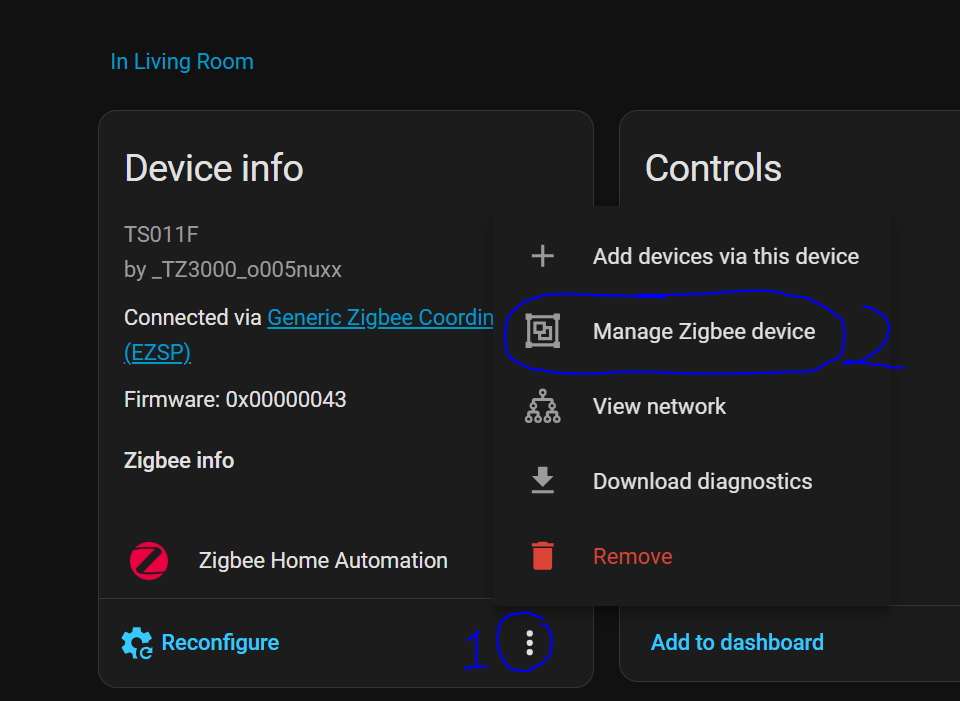

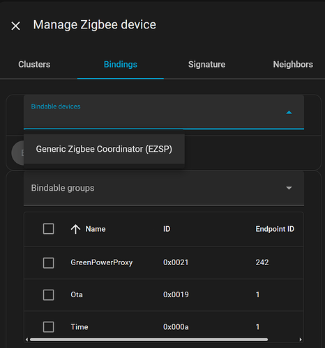

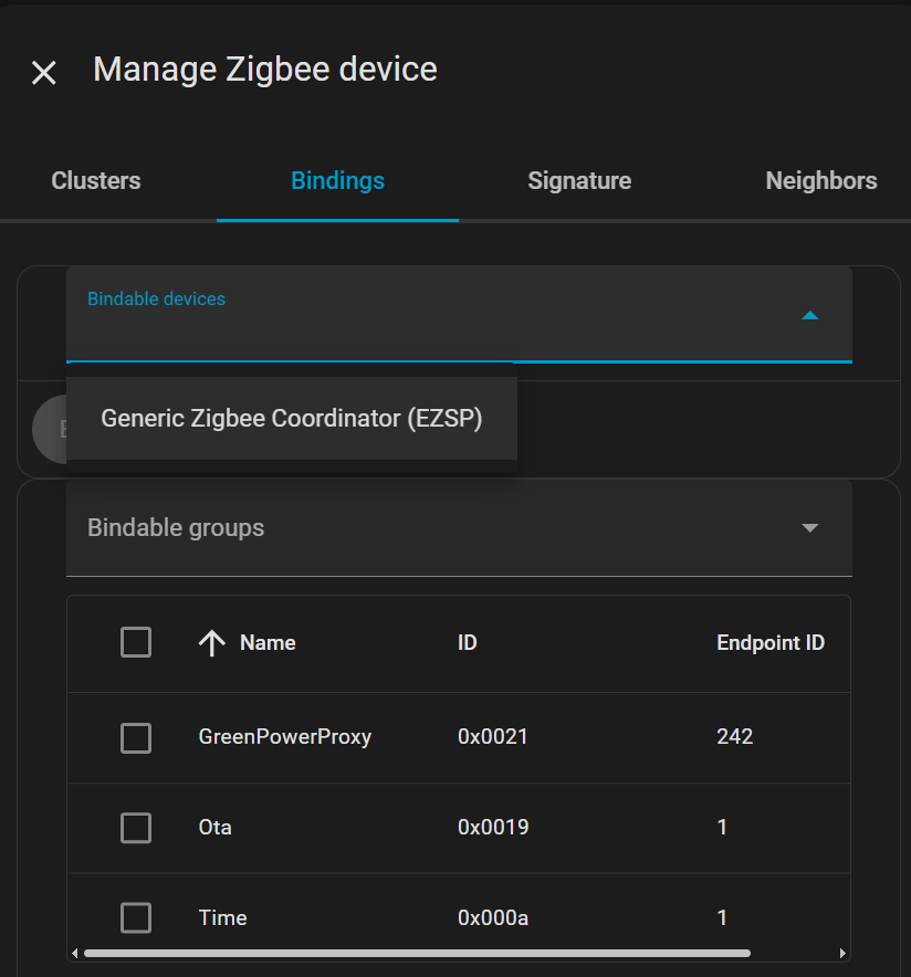

You should be able to bind directly in the UI if you can get the Shelly to show up as a bindable device for your button.
  • Open the device page for your button. Click the 3 dots next to “Reconfigure” & select “Manage zigbee device”
  • Click the Bindings tab and check whether you can see the Shelly in the list of bindable devices. In my case, I only see my coordinator because this isn’t an end device:
Hey @ShadowFist thanks for replying. Yes I can get the Shelly to show up as a bindable device. I’ve also tried adding it to a group and attempted to bind to that too. On both occasions it gives me positive feedback on the bind yet clicking the ZG-101L doesn’t trigger the Shelly.

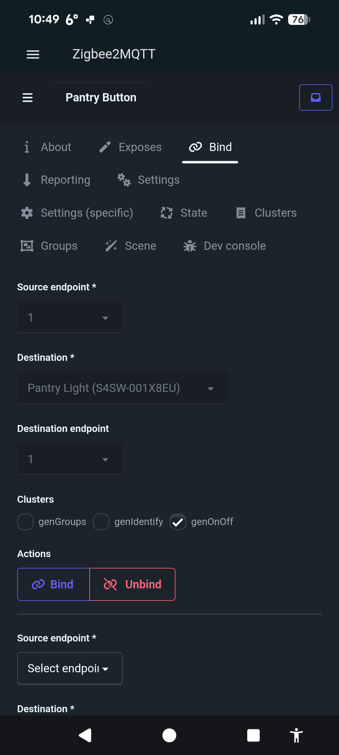

So I’ve migrated to Z2M and I think I’ve successfully bound the button to the Shelly but still no joy.
Do I need the button to be in event or command mode? I get an error when moving trying to put it in the latter.
Any tips on debugging this issue?
UPDATE: according to this reddit post, it’s not the button’s fault but Shelly’s.
https://www.reddit.com/r/homeassistant/s/lrXt1P7mlA
