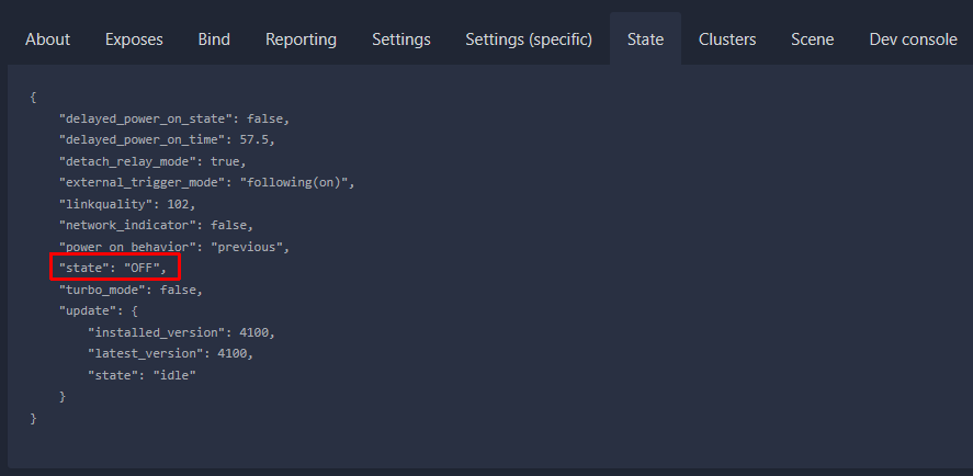

Has the detached relay mode been fixed in Z2MQTT yet?
I’m not entirely sure how it’s supposed to work, but shouldn’t it show 2 on/off entities at least in detached mode in order to read the switch state independently of the relay state? I see only one on/off state here:
Is this still a bug or “by design”? And does the switch show up as an independent sensor in ZHA?
No. The switch itself has no state. Only the relay does.
This applies to all devices with or without detached mode. If you look at something like a wireless switch, it won’t even have a state since there’s no relay
Sorry for the noob question, but how would I be able to set up an automation based on the switch independently of the relay (detached mode) if it has no state? Maybe I don’t get what the detached mode actually does… If the “state” is the relay state, it won’t change when the switch is pressed in detached mode, right? Then how is a switch change (not relay change) communicated to HA?

I moved from ZHA to Z2M and I can do the detached with the capability to automatically revert to attached if the zigbee network is down. I have done partial testing, but it looks good.
In detached mode, the physical switch seems to only generate the event “toggle” to trigger an automation. It is also a bit slow since it miss to generate a second event if the physical switch is toggled in less than 2 seconds.

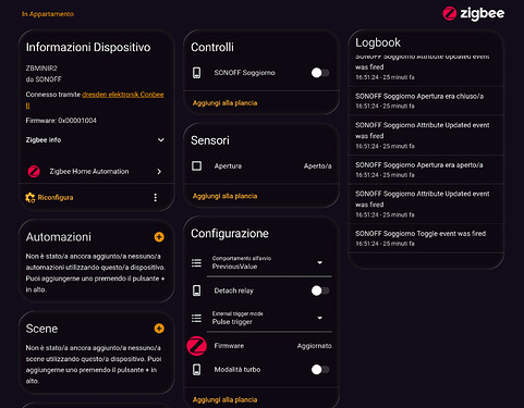

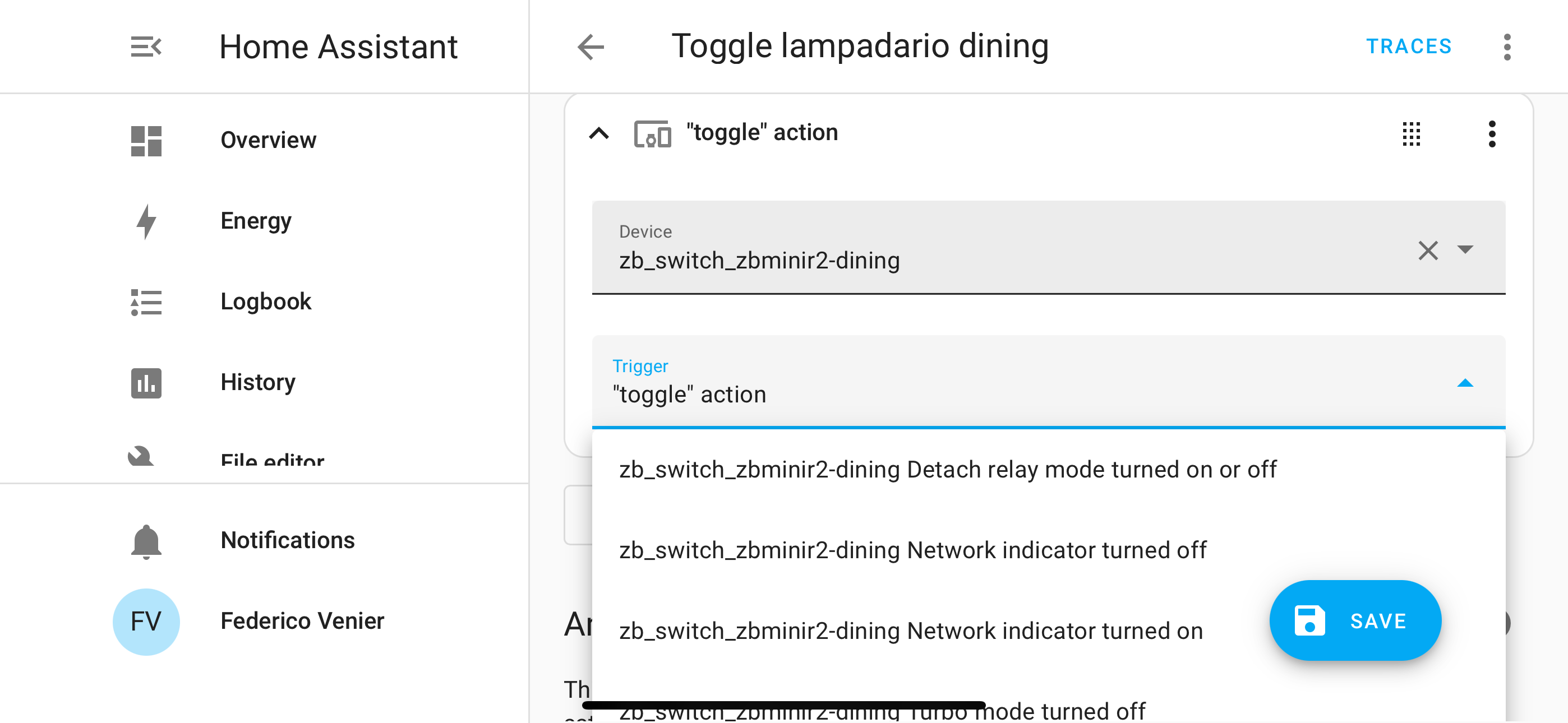

Recently, I bought four ZBMINIR2 to replace dumb relays and switches, and to my surprise, they seem to be working just fine with ZHA under the most recent version of HA.
I don’t need detached mode at the moment, but it seems to be working just fine.
Setup
I’m using a RPi 4 Model B running Home Assistant OS 16.1, Core 2025.8.3
The coordinator is a ConBee II with latest firmware.
All relays have firmware 0x00001004, I don’t have older ZBMINIR2.
I replaced two standard relays, so the Sonoffs receive a 230v pulse on S2 when I push the buttons (Pulse Trigger mode), while the other two replace normal switches (Edge Trigger mode) with the interrupted phase sent to S2 (so it’s either 0v or 230v depending on the state of the switch).
I have no Sonoff that uses a closed loop between S1/S2 as trigger, so I can’t say anything about that configuration.
All four Sonoffs have Detached relay disabled and PreviousValue for power on state.

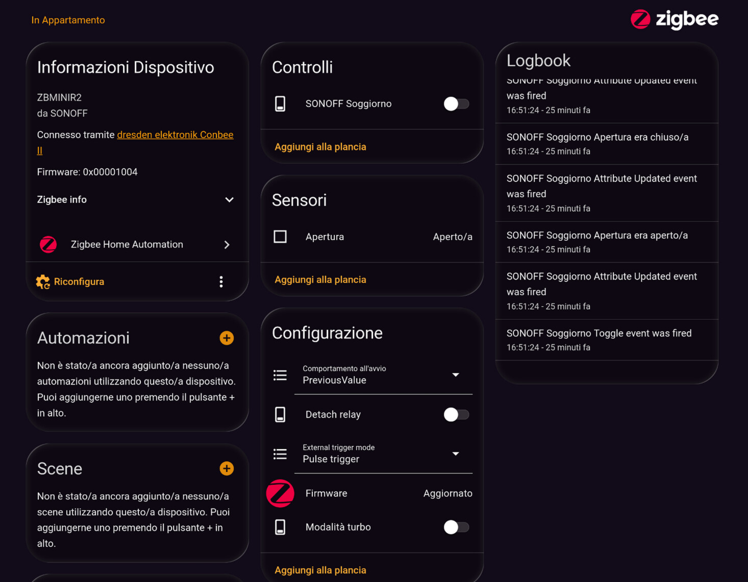

Behavior
With detached mode disabled everything works as expected, I only get this warning from time to time, probably due to low signal strength:
Unexpected transmit confirm for request id 250, Status: TXStatus.SUCCESS
Apart from that, I can control the lights both from HA and the physical switch directly, so they still work even if the RPi somehow dies.
If I turn on Detached relay, the physical buttons and switches will not affect the state of the relay, but they trigger the 7 events when I use them:

From what I can see, if I turn on Detached relay, a Toggle event is always fired (among others) every time I change the state of the S2 input, which can be easily implemented into automations. The Opening entity doesn’t really do anything useful apart from toggling itself twice, so I will probably ignore/disable that entity.
The LED of the SONOFF is always still, it never blinks.

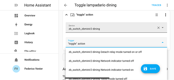

Hi @Muiss, you beat me on time!
I was diving into GitHub in search of this issue, and this is the PR in zigpy that implemented the fix.
This version of zigpy (0.81.0) was included from Home Assistant 2025.8.0b1 so if you update to the latest version, the ZBMINIR2 will work natively on ZHA (probably you will have to Reconfigure the relays).

This is now all working with ZHA. In detached mode on and switch turned on; when you flick your physical switch, you’ll see the Opening sensor Open (on) or Closed (off). Use this attribute to automate your lights on and off.
