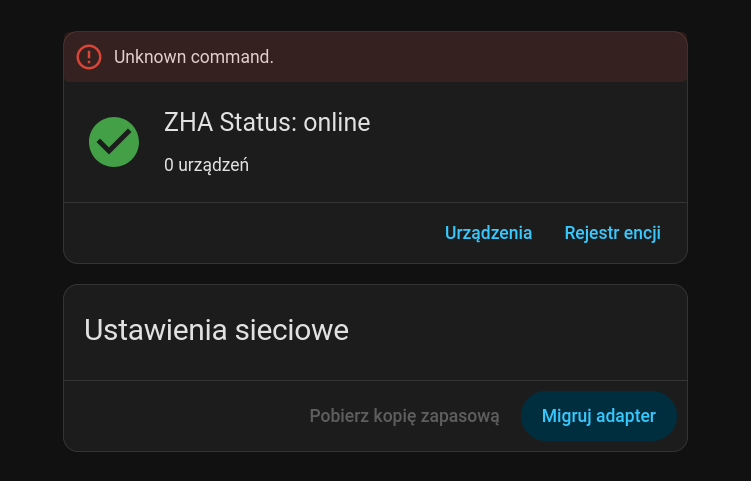

I have a weird home setup requiring me to use two ZigBee networks. The first one is using SLZB-07 connected directly via USB to my first Zigbee2MQTT server. Today I received SLZB-06MU, which is using Ethernet. I configured second Zigbee2MQTT network as usual, added my devices, then realized there’s a Zigbee entry in my Home Assistant settings, indicating ZHA. When I go in there, I get “Unknown command”, but it seems to actually be installed? I literally clicked “Ignore” for ZHA and SMLIGHT integrations few minutes before.
How can I get rid of that Settings entry and make sure that ZHA doesn’t show up? I’m happy with Zigbee2MQTT hosted by myself and don’t want ZHA.

Okay! I FINALLY was able to figure out what’s happening! :partying_face:
It turns out I had some “ghost” configuration leftovers in my configuration.yaml file.
If you’re facing this, double-check your config for the zha: block:
zha:
  custom_quirks_path: /config/zha_quirks/
  zigpy_config:
    ota:
      otau_directory: /config/zigpy_ota
      providers:
        - type: ikea
        - type: sonoff
        - type: z2m
      extra_providers:
        - type: z2m
          url: https://raw.githubusercontent.com/Koenkk/zigbee-OTA/master/index.json
The fix: Delete/comment the entire zha: block, save, and restart Home Assistant.
The icon should finally be gone!
Hope this helps!
