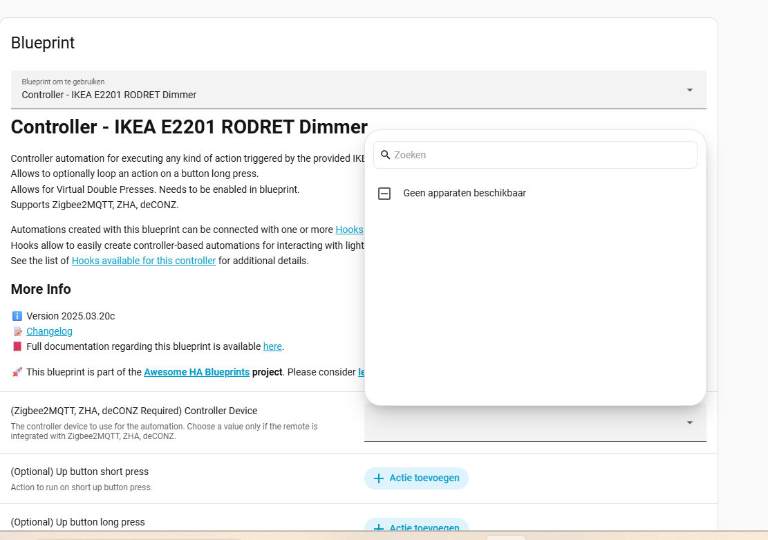

Hi, I’m trying to use this blueprint with zha but it says no devices available. Can’t figure out what’s wrong

Dropdown alongisde ‘Controller Device’ only shows ‘No Devices Available’ despite device showing in ZHA, as “RODRET wireless dimmer”
I checked suggestion from @Damiendhn above, and it appears the Blueprint YAML now matches this already.
Any further suggestions please?

Same issues not recognising the device.
I had the same problem with this blueprint, no devices available.
First time I digged a little deeper in a blueprint and fixed it, solution is mentioned already above for me.
What to do (in my case using ZHA) was simple, i hope it helps for you all.
Edit this file: “EPMatt/ikea_e2201.yaml”
Find under the “input:” section your zigbee integration.
Change the model name to the right one.
My xml looks now like this:
  input:
    controller_device:
      name: .... text ....
      default: ''
      selector:
        device:
          filter:
          - integration: zha
            manufacturer: IKEA of Sweden
            model: RODRET wireless dimmer
In my case the model mentioned was RODRET dimmer and should be RODRET wireless dimmer. You can find the correct name under the device info of the device (zigbee > select divice from the list > device info).
Hope this is understandable for everyone.
Thanks mate, solved my problem. Cheers.

I cannot select device (ZHA)

This worked for me, thanks for the tip!
I simply edited it in the file editor app in HA and gave it a reboot.
