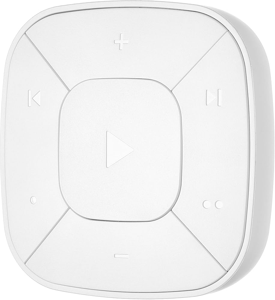

I’ve been working on a blueprint for controlling a media player with the IKEA STYRBAR E2313 (the white 4-button remote) via ZHA, and after some debugging I’m happy to share it here.
:joystick: Button Layout
Button Short press Long press
â–² Top Play / Pause Mute toggle
▼ Bottom Stop (empty — customize freely)
:arrow_backward: Left Previous track Volume down (repeating)
:arrow_forward: Right Next track Volume up (repeating)
:wrench: Features
Play/Pause, Stop, Next/Previous track on short press
Smooth volume control on long press — holds and repeats until you release the button
Mute toggle on long hold of the top button
Configurable volume step and repeat interval
Works with any media_player entity (Sonos, Chromecast, Music Assistant, VLC, etc.)
:bug: Quirks handled
This remote has two known ZHA quirks that required special handling:
  1. The on-event quirk on left/right hold
    When you hold the :arrow_forward: or :arrow_backward: button, the remote fires this sequence of events:
press → on → hold → release
The extra on event would incorrectly trigger Play/Pause mid-hold. This blueprint uses wait_for_trigger with a 400ms window to detect whether a hold follows the on event — if so, Play/Pause is skipped.
2. Asymmetric hold behaviour on left vs. right
The :arrow_backward: left button repeats hold events natively while held down. The :arrow_forward: right button only sends a single hold event followed by release. Both volume actions now use the same loop pattern: adjust volume → wait for release or timeout → repeat if no release received.

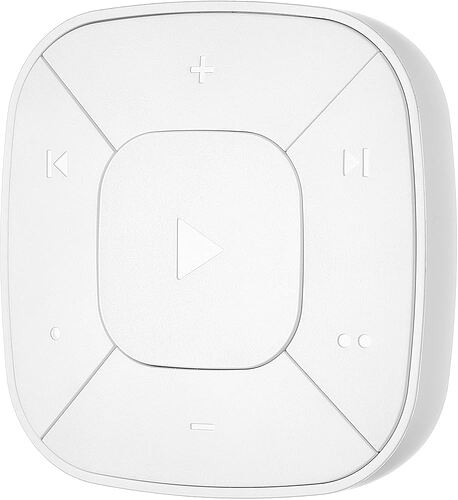

I believe this IKEA remote is more intuitive as a media remote.
