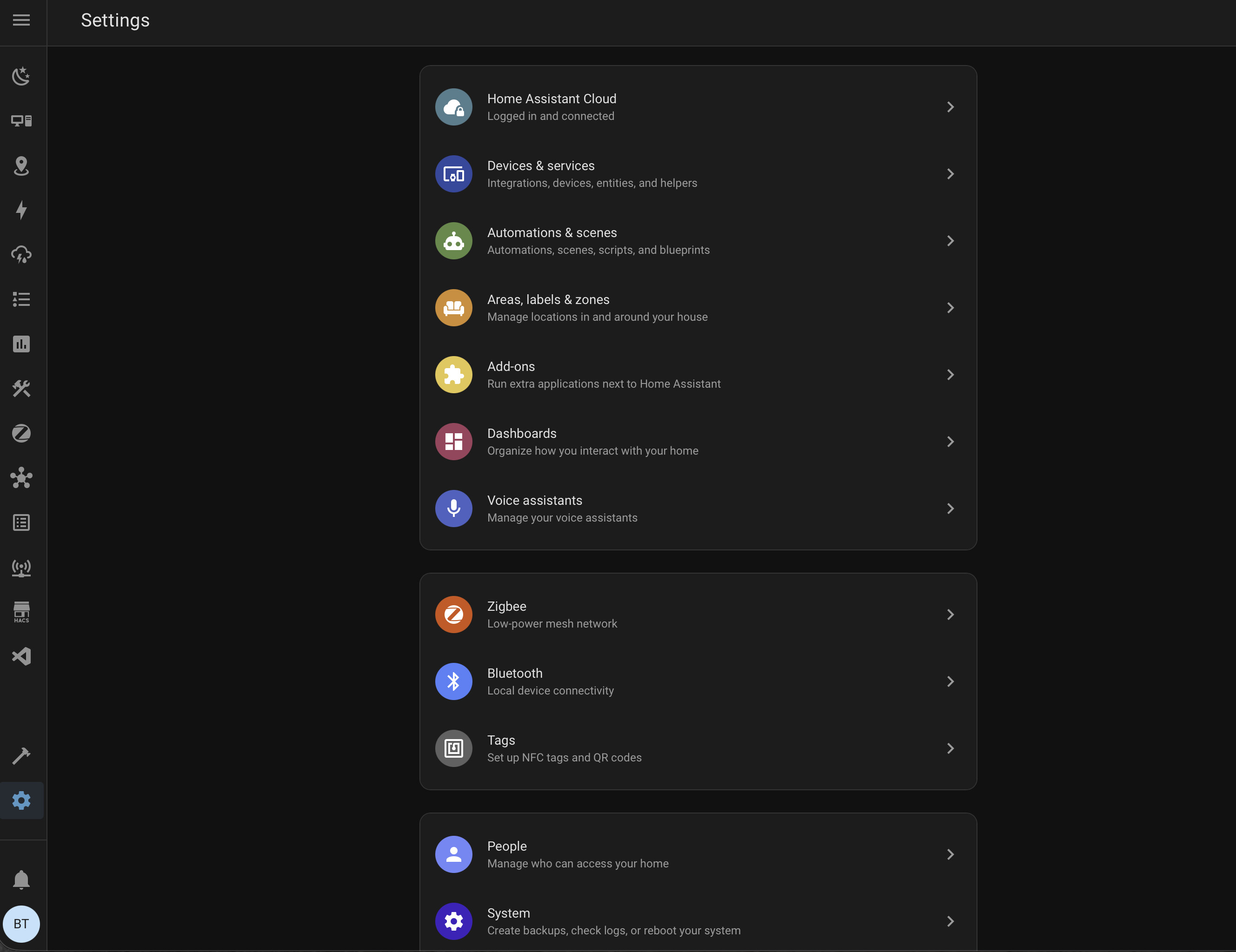

The most recent updates of HA have changed the main settings menu to now include a dedicated link to “Zigbee” which takes you to ZHA settings. I don’t even have ZHA installed as an integration as I use Z2MQTT.
There doesn’t seem to be any way to remove this from the settings menu.

FWIW, ZHA becomes one of the Ignored integrations when MQTT is integrated. Fine and well, those are out of sight by default. But on the Settings page ZHA is in yer face, though it has no devices associated. But then again, not having any Tags set up, that integration is also in yer face & redundant.

Nothing to do with the sidebar. . . ZHA not integrated, MQTT is. Yet, Settings shows. . .
Select Zigbee there, and it says ZHA is online.

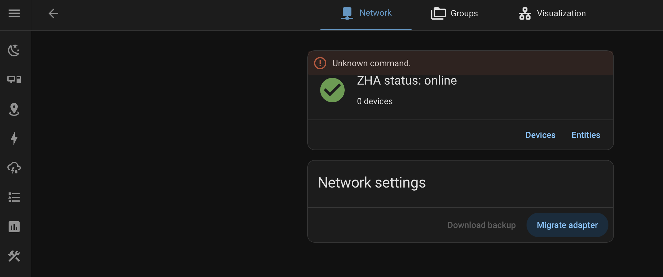

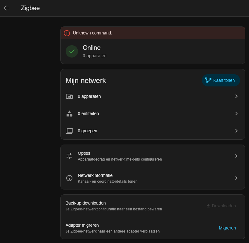

Same problem here, though ZHA was installed at some point, after hooking up a Conbee II. As far as I know, ZHA is deleted (from integrations), but when I click Zigbee on config/dashboard in the list containing Matter, Thread, Bluetooth and Tags, I get
I do not see a delete button to be able to stop the “No ZHA gateway exists, skipping coordinator backup” log messages.

@bob.t I know, read that also, there’s nothing ZHA-related in there. I did not do anything with ZHA after it ended up installed, I immediately deleted it and ended up with this situation.
Sorry, that’s all I’ve got in this regard. I’m using a ZBT-2 now on an HA Green, if the hardware matters in this regard.
