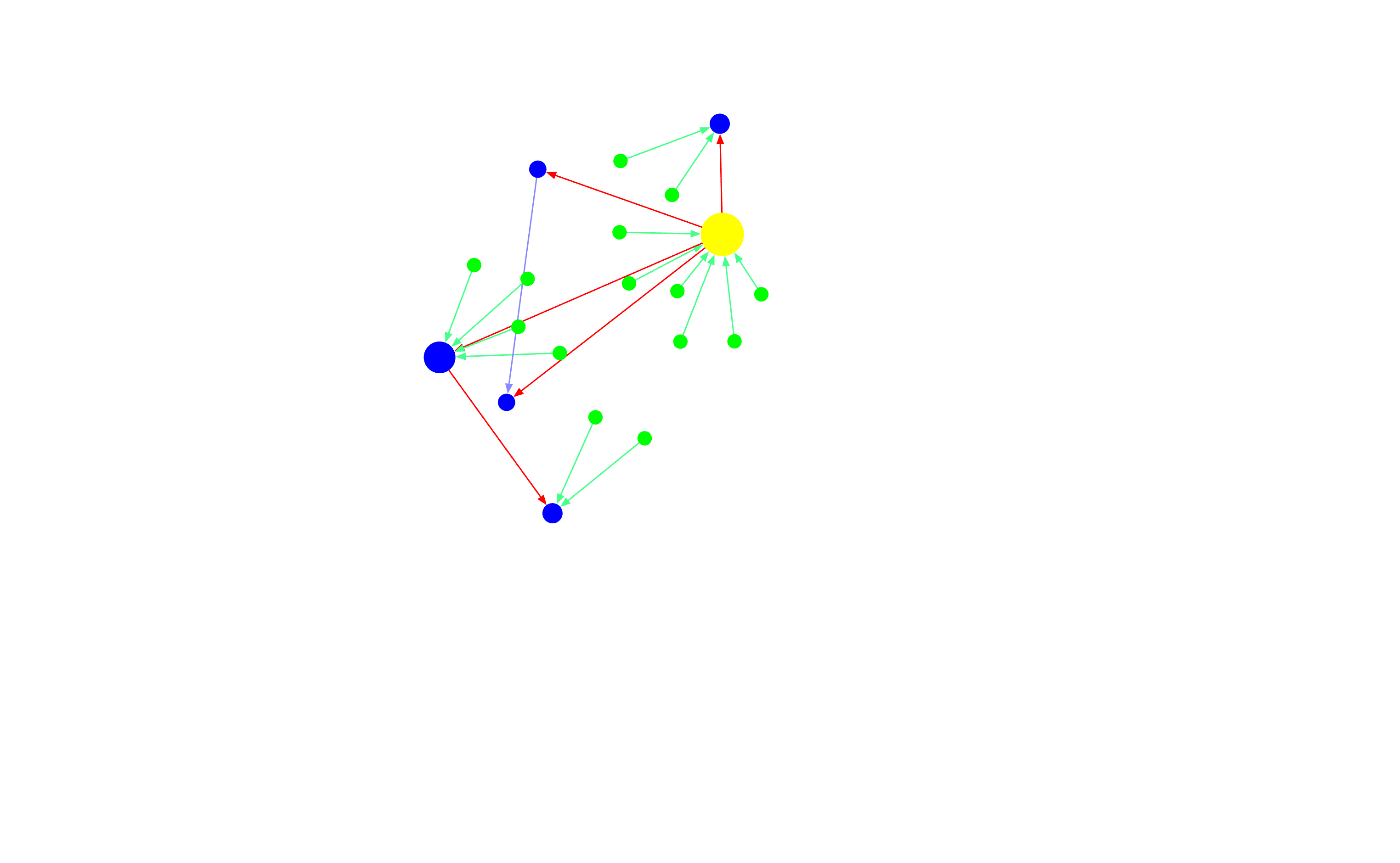

  • Routers are always online but the “map view” doesn’t show links for some. Plugs and valves are online and controllable (like on/off).

I don’t get a mesh build up at all. And the shown router that is working but doesn’t have a link in the map is in the middle of two others. One indoor wall, one wooden wall to the other and max. dist. <10m.

what is a reasonable distance between them (as mentioned within 10m and one wall in between they do not form a mesh!) and how could I measure the current bandwith etc.?
Is their any way to manually influence the mesh build up?

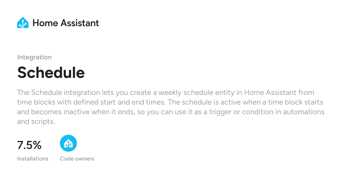

To give you an idea what might make it easier (and how I use it currently): AVM (now called Fitz) does it with their DECT thermostats basically by giving you two temps (eco and comfort e.g.) to set. You only select one (e.g. comfort) and “draw” the slots. All others slots will be set to eco.
Maybe you know that solution too?

Yes, unfortunately setting up the schedules is a bit of a hassle.
The Climate Group Helper just supports the core schedule integration.
You can also create your schedules via YAML, which is probably faster than using the UI.
I edit the ‘.storage/schedule’ file directly and then restart immediately.
But that’s probably more of a hack than a practical solution.

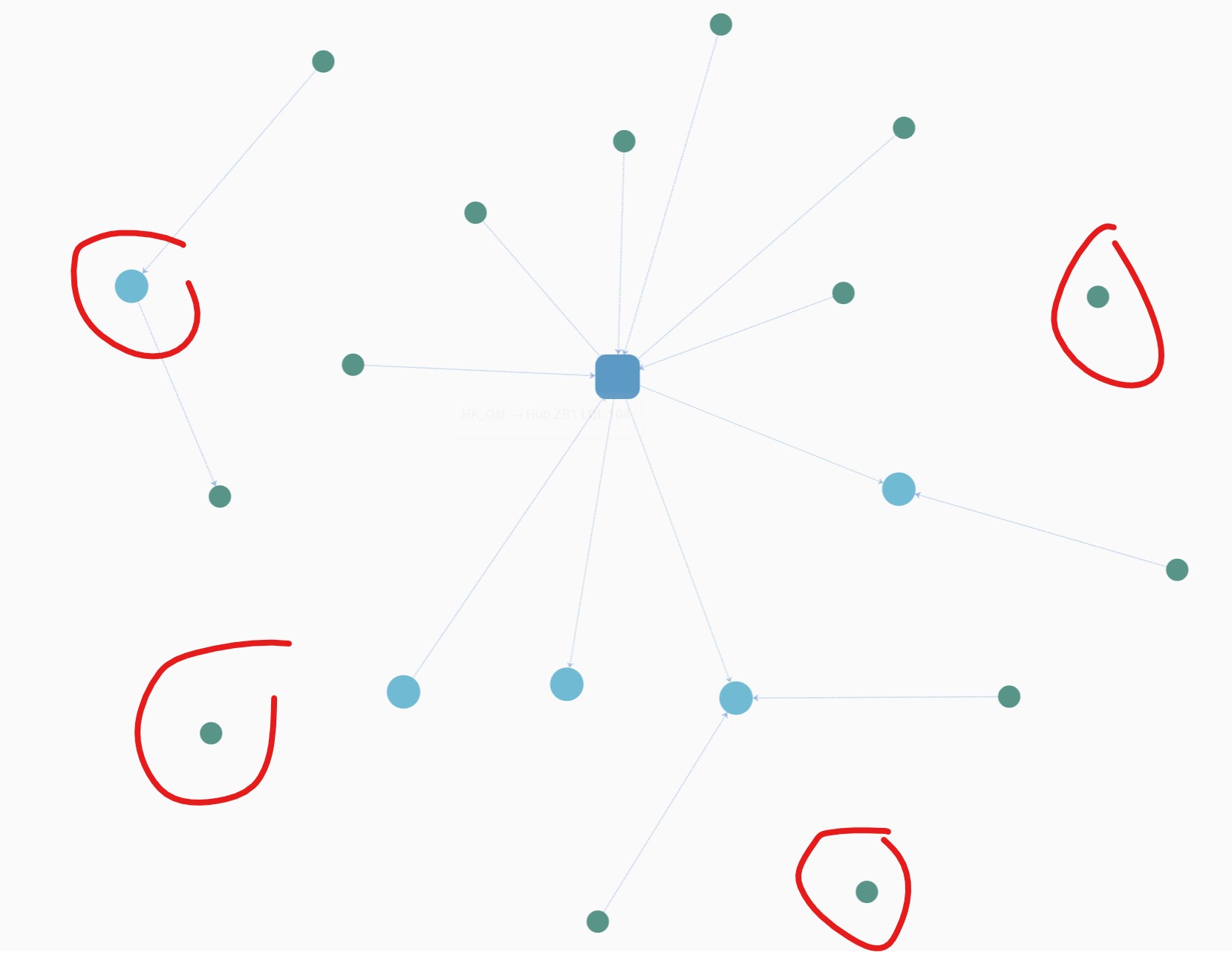

I changed my ZB from ZHA to Z2MQTT and now, without any change regarding the hardware it works fine, builds the mesh and all sensor are only right away.
As I expected and can now see visualized it was not an issue related to the sheer number of routers or the quality of my walls :slight_smile:

my ZHA issue was, as I assumed, obviously not a hardware issue or some kind of “not enough” hardware. I switched to MQTT and that’s it. Automatically built mesh link, direct links AND all my devices are fully supported now. Especially the electric floor heating thermostats that never did when using ZHA.
Checked all kinds of restarts and updates, reenabled my 2,4GHZ WiFi, relocated the coordinator to a less ideal position. Disconnected/relocated one router (plug), hard rebooted/powercycled the RPi, AOK…
