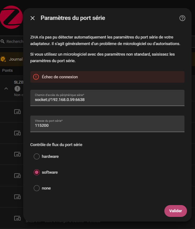

Hello, I've had HA running on a Synology Docker container for two years and I replaced the Zigbee coordinator with a SMLight. It worked fine for several weeks, and then one day after what I think was an HA update, I couldn't access the coordinator's socket: SLZB-06M. Configuration failed, retry: ... I tried deleting ZHA and changing the port via the Z2M web interface, but nothing works... I'm devastated... can you help me? I don't know what to do anymore. * Path: socket://192.168.0.24:6638
  • Speed: 115200
  • Flow control: none
  • I have 52 Zigbee devices that are stuck in Home Assistant

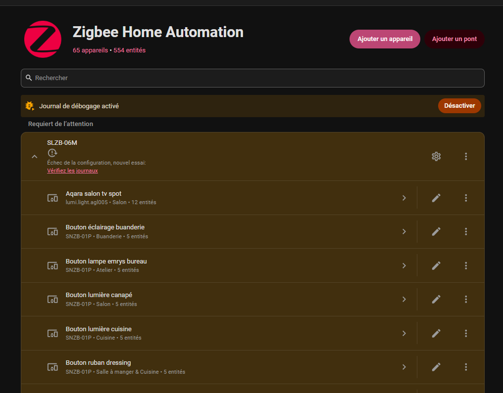

The picture is of ZHA entities.

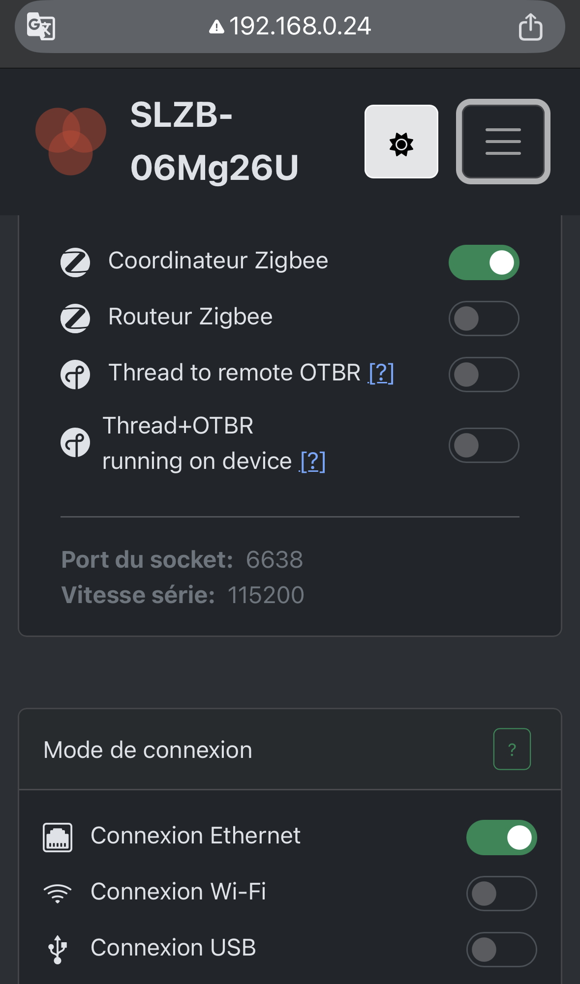

I only installed ZHA in Home Assistant. My coordinator is a SMLight network key on a PoE port via RJ45. I access the key via its IP address; it is fully functional and in Zigbee coordinator mode. Therefore, I only have one Zigbee instance via ZHA in my Home Assistant Docker container.
And in home assistant integration zha , I have a no access with the key zigbee coordinator on my host
The Zigbee coordinator is no longer reachable since I updated Home Assistant to its Core version: 2026.6.2 User Interface 20260527.5 Companion Application 2026.5.0 (2026.1984) Before that, everything worked perfectly with my 52 Zigbee devices via ZHA.

Is the speed correct?
FW versions with speed 480800 have been released.
I tried changing the speed to 480800, but nothing changed. I loaded an older Home Assistant backup, but it still gets stuck trying to access the SMLight key. The logs show SMLight key rejections, and even downgrading the firmware doesn't change anything; it's a connection refusal.
