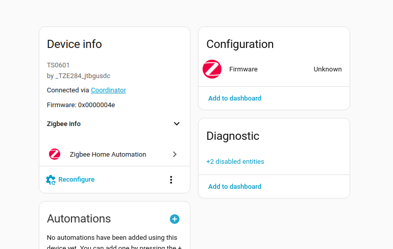

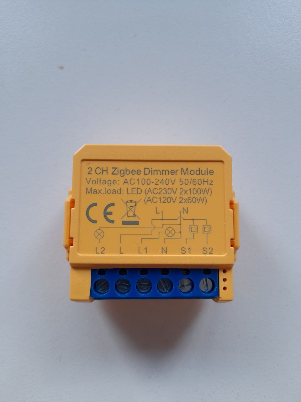

Hello.
I found unsupported device due a new integration activity, it is 2-channel Zigbee Dimmer module BXBO-XV-BD.

It it possible to add support for this device?
Thank you

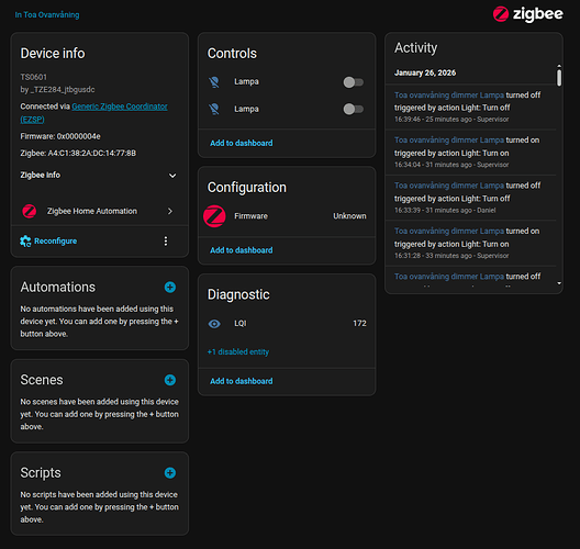

Nice, this works!
I did notice that changing the brightness in Home Assistant is not exactly corresponding with the brightness of the lamp. For example, setting brightness to 25% is sometimes very bright, sometimes completely off. Feels like the level control is not fully correct yet?
