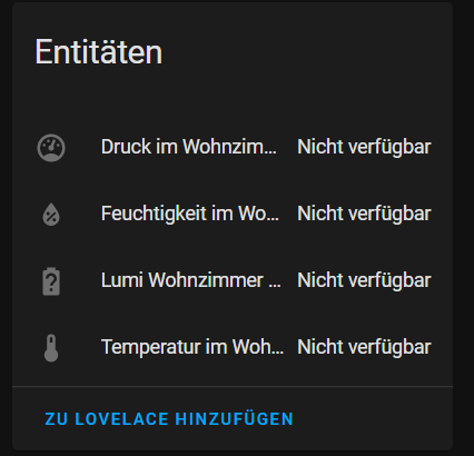

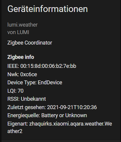

so i had some trouble with my ZHA intergation. Some zigbee devices (aqara temp sensors) did not send data for 2 days. So some automations are not running correct.
I changed the timeout value back to default but now all devices are unavailable. They come back if they send new data to ZHA but they are gone again seconds after that.
Im probably gonna redo all my zigbee stuff but maybe there is a way to get it running again without resetting everything zigbee related (also i have no idea what to do)
Just readding a device didn’t improve anything.
Also is ZHA the right solution? Im having a CC2531 Stick which has anough range for my apartment but i think it loses connection sometimes. So maybe i need to buy a “better” stick?
Maybe with or without the stick what would your recommendation for a new software?
Here a some pictures:
