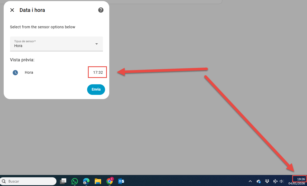

Example: I’ve an IKEA Parasoll door sensor in my car park. When i open or close the door, the event is registered aproximately 2 hours in the past. (If I close the door at 10:35, the event is registered at ~ 08:40 h). I installed the HA Time & date service, and the tool reports that the system time is near to 2 hours in the past:

Is your timezone set right in Home assistant and everywhere else? (Routerm server hardware, etc?)
Open your Home Assistant instance and show your general Home Assistant settings.
And how is that card configured?
When working with time it is important to think timezones into every action.
The timesnin HA is generally stored in UTC time and needs to be converted to local timezone when shown to the user.

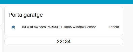

Hello Everyone. After beeing during a whole day triyng to solve the time issue, I’ve placed a time window in my instance main view, and… the time indicated is correct:

The picture of your time is of no use to us, since no timezone value is given.
All times given should be suffixed with a timezone value or it will be impossible for us to deduct anything.
