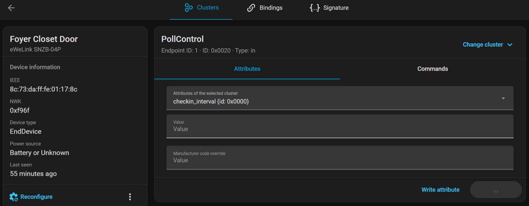

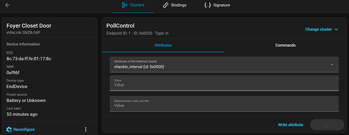

I found how to reduce the number of times this error occurs. You can set the checkin interval to some insanely large time (seconds). Then the error will only happen when that time elapses.
To set the value, press the button on the device and then click “write attribute” immediately. You may need to read it back to ensure it was written properly. Reading back also requires a button push on the device to wake it up.
That value should be less than the default 6 hours for ZHA to check in:
If you set the value to be higher, then you’re going to keep running into the issue every time the 6 hours pass.
It might be easier to just change the default setting in ZHA from 6 hours to something a bit higher. For some perspective, the default polling for battery devices in Z2M is 25 hours.
The unavailable diagnostic is a global timeout and is different from the check-in interval.
I set the check-in to a week. The error only happens once a week.
