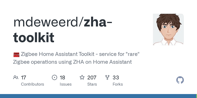

I don’t know everything, but I don’t know what zha_toolkit is, and I searched the HA docs and the string doesn’t show up as far as I can tell.
Maybe the problem is I don’t know where this is:
Are you looking for this category maybe? Development - Home Assistant Community
It seems very handy, main thing that I’m looking to grab is the “last seen” variable for devices.
I use a temperature sensor in a freezer that I’ve converted into a keezer for beer and it the temp sensor fails I need to have an automation shut down the freezer quite quickly to avoid my keg of beer becoming an ice block :smiley:
more info here;
