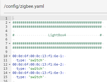

My light switch was recognized and the value did not change when operated at local.
I changed the type of device to ‘switch’ and checked for a change in value.

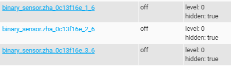

The problem is ‘binary_sensor’ as shown in the picture below.
I don’t know how to change the type of this.

Because my light switch is three-gang, I was recognized as three switches and modified device_config as shown in the picture below.
I wonder if the above ‘binary_sensor’ can be modified in this way.

I want to process all the data on a zigbee device into the type of data I want.
For example, I want to change the type of ‘binary_sensor.zha_0c13f16e_1_6’ to sensor.
I’m afraid it doesn’t work that way. That binary sensor is most likely a “client On/Off cluster” on your zha devices, so zha platform mapped it to “binary_sensor” since binary sensors are used for entities with “binary” states, like On/Off, Open/Closed etc
