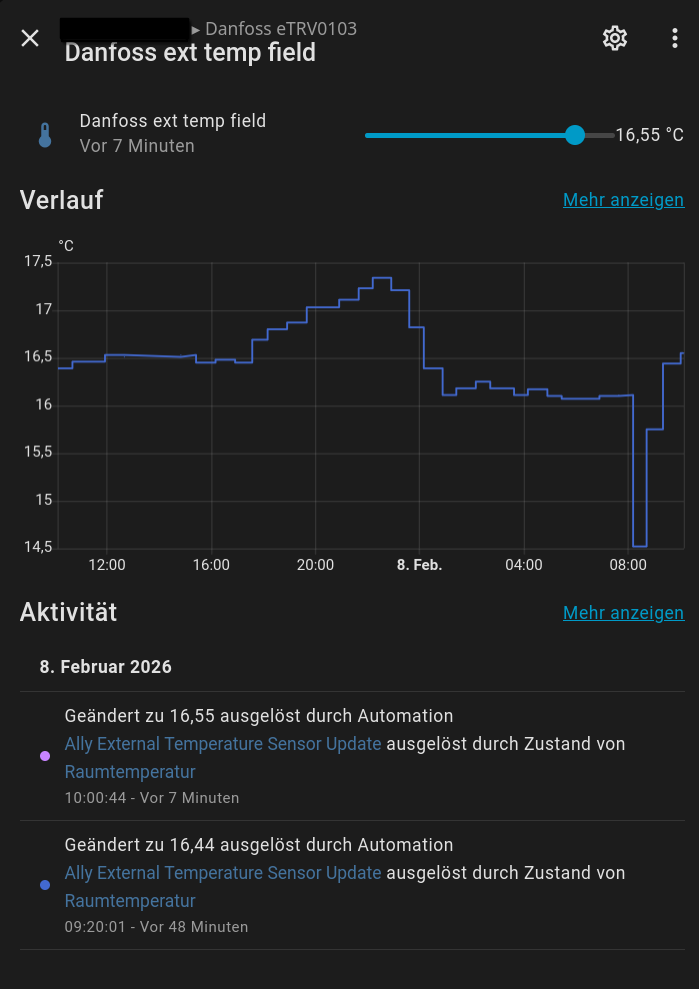

Since some years have past, I’ve created an updated blueprint for ZHA, using the external temperature field of the updated zha quirk and I improved the description based on your very helpful explanation with post #5
