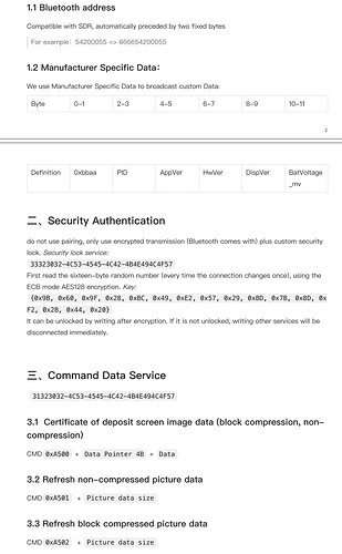

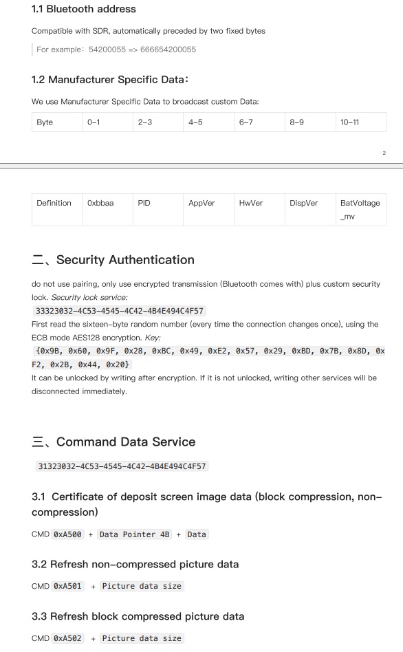

The seller is very helpful, even sent me BLE protocol spec including auth challenge AES key.

I’ve purchased one of these ESLs from AE and I’m experimenting in communication with it using the information you’ve posted above @DonLuigi . Unfortunately, whilst it responds to bluetooth connections, I’m not getting positive responses from it. Perhaps the “custom security lock” needs someone smarter than I to work out how to connect to it.
NotFoundError: No Services matching UUID 33323032-4c53-4545-4c42-4b4e494c4f57 found in Device.
or
NotFoundError: No Services matching UUID 31323032-4c53-4545-4c42-4b4e494c4f57 found in Device.
and on querying services…
NotFoundError: No Services found in device.

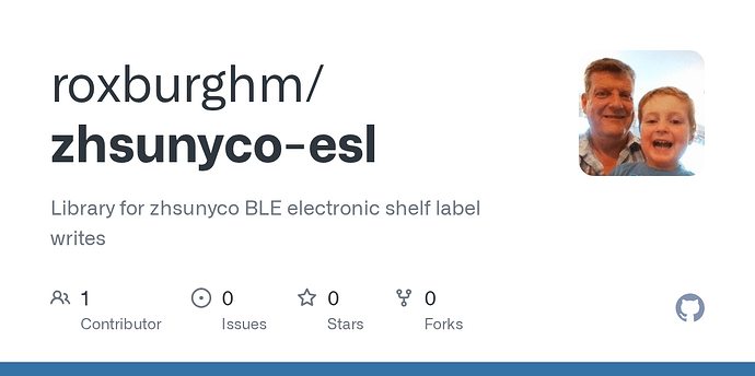

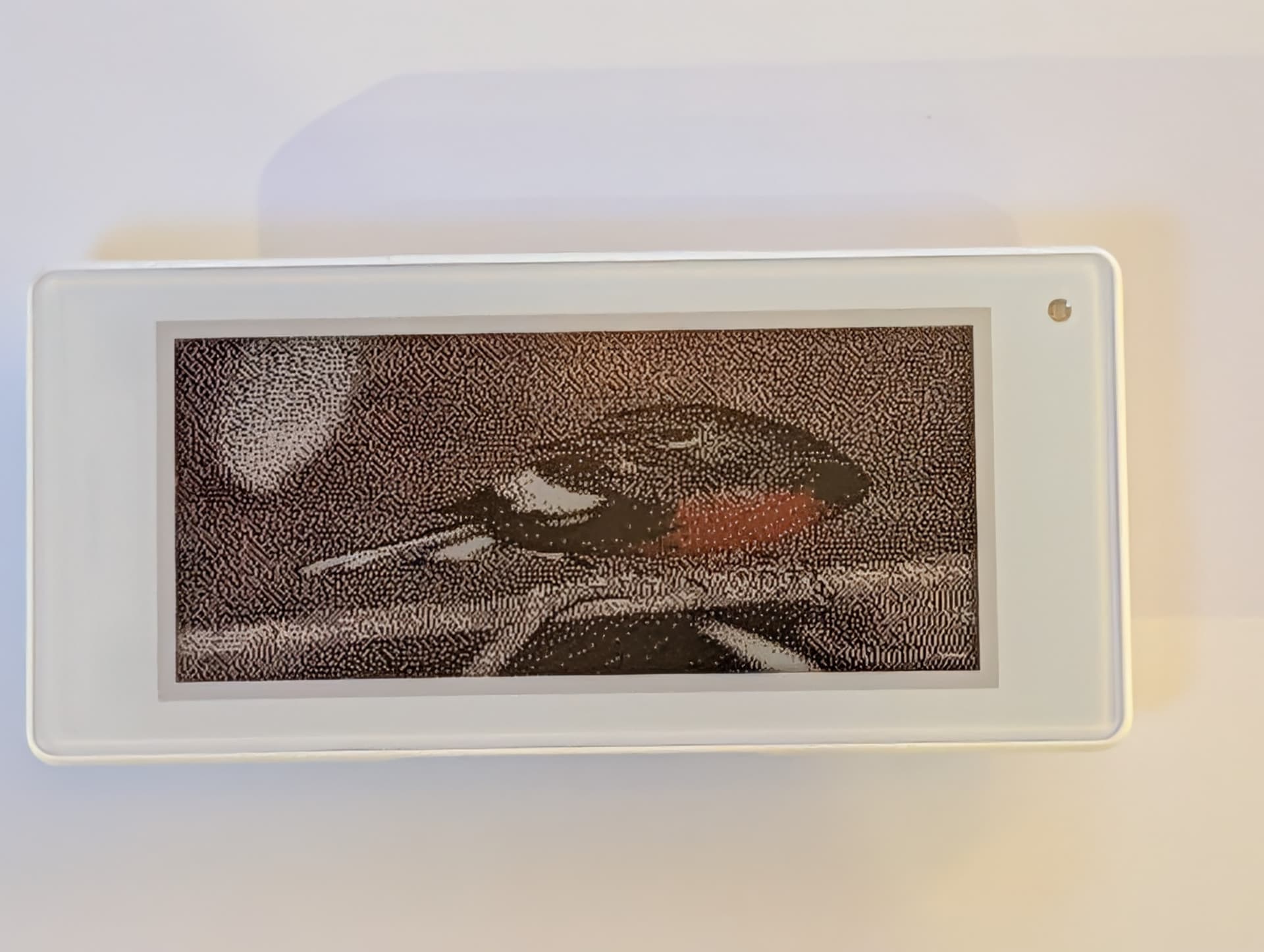

Got this working in python if it helps.
A little bit of Claude and it works on ESP32 too
Matt, this looks absolutely amazing. Will give it a go this weekend. I glanced over your source code. I imagine it was quite a bit of work?
Just looked through the android app to see what it was doing. Once working I used Claude to generate samples because why wouldn’t you. And Gemini to reword protocol docs because “me not do words good.” :joy:

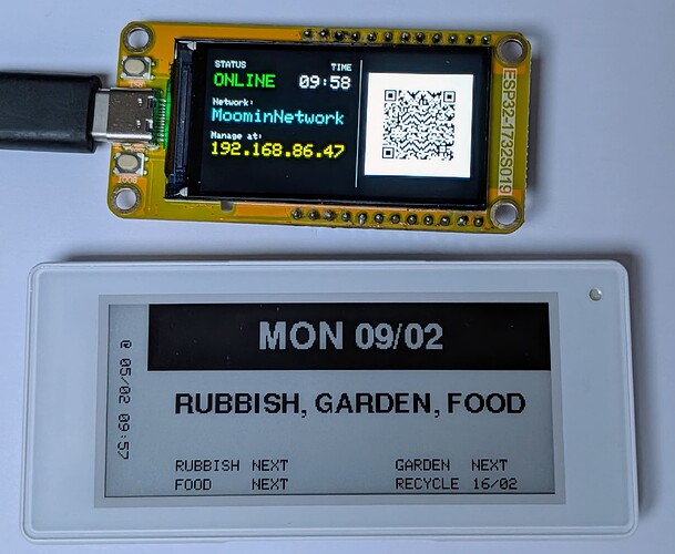

Stopped looking now as I can now do bin collection day eink tags which was my aim.

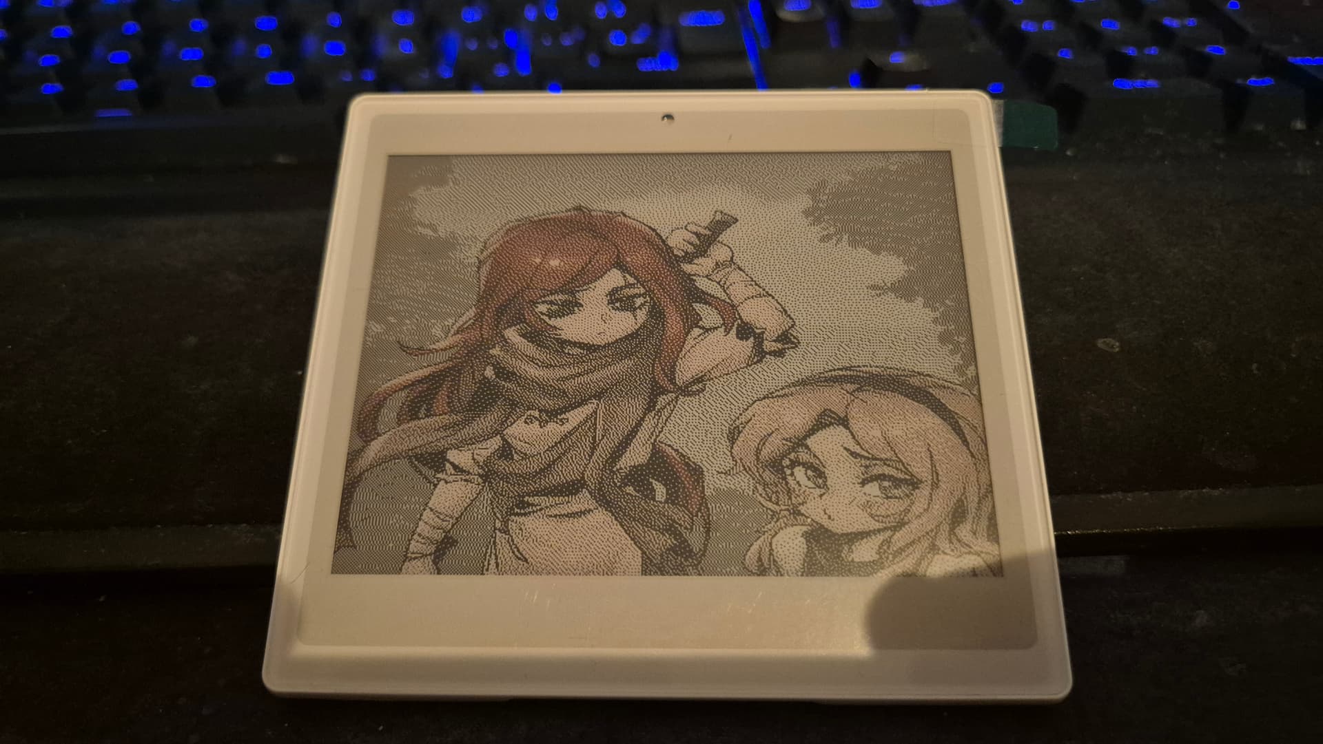

Great. Just, it seems you have an ESL from different manufacturer, not Zhsunyco. Or maybe Zhsunyco have different lines of products? Mine looks like this, yours looks different. I opened a ticket on github with more info
It took me a while to understand that “Rubbish garden food” was not the menu for today
:rofl:

Thanks a lot! I have a differently sized display apparently because the image appears distorted for me but I’m just happy that it works at all!
Now its just a matter of throwing AI at the issue until its working properly.
Edit: or just fixing the resolution in the parameters apparently. lol. I’m getting lazy.

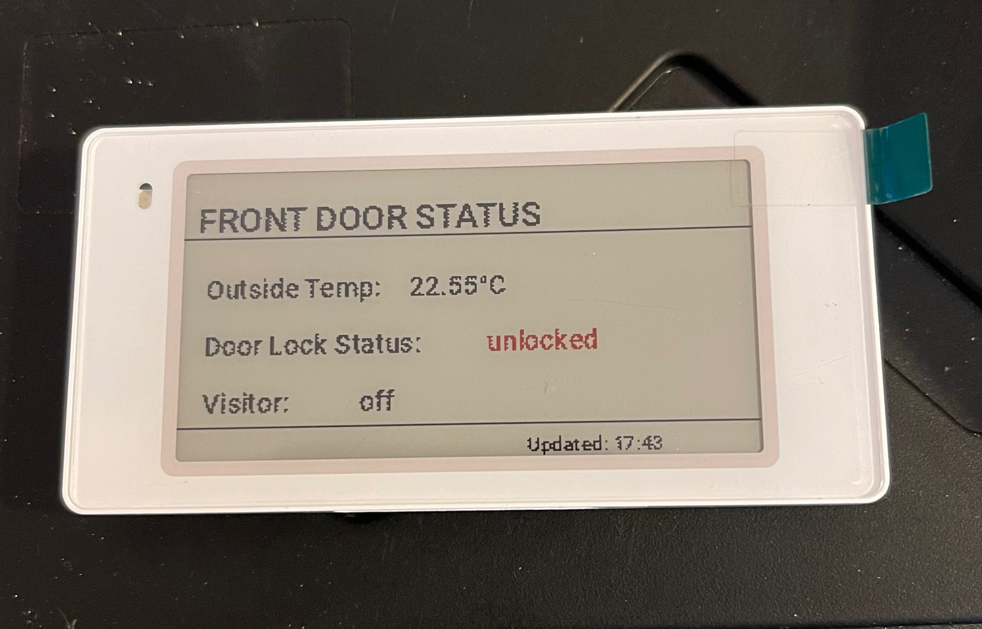

Hi did you get this working? I have a BLE-266BWRY its a 2.66inch screen, it took little working out but I have got this working connected to my bluetooth of the PC my home assistant is running on I have two integration using HACS custom integration these are E-Ink Display Manager and Wolink BLE E-Paper Labels, using these integrations and altering the wheel file in the Wolink and adding my screen size I got this to work
shorti1996/zhsunyco-esl-wolink (integration)
shorti1996/eink-display-manager (integration)
Better late than never - i have also created a HACS Integration that uses ESPHome BLE Proxies so the ESL can be further away from the HA Server.
I only tested it with the BLE-350BWRY, more labels are in the mail.
It’s still very beta, but feel free to check it out:
https://github.com/zitroaen/BLE-ESL-BWRY
