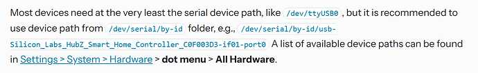

Stole the below from the ZHA docs. Z2M docs mention it too, but make it more complicated to get the ID.
Go into your Z2M config page and change the coordinator path to use /dev/serial/by-id. Using the serial path is subject to change when you restart your server.
Extra info
On the supervisor page you see the 3 dots. Select hardware and find your stick there. Copy this path and use it in the configuration as mentioned above
