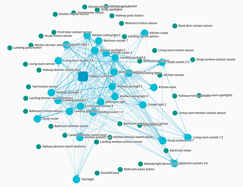

Attached a part screen shot of system if it helps, also im running the latest upgrade

Edit: In your image you seem to have quite lot of routers, but not many connections between them. A possibility is that they’re a bit too far apart to form a robust mesh.

@jackjourneyman as for routers I have five plugs in the loft that are all about 1 meter away from each other in my kitchen which is Tiny I have 2 plugs at high level and one behind the cupboard I have a plug in the living room I have a plug in the dining room and I have a Center core of five bulbs going up my stairs I don’t think I’ve got any more spaces to put actual routers ha ha. This doesn’t include my two plugs in the garage and then proper outside socket in the back garden full stop oh and I missed out another router in the living room and various bulbs and azigbee extender in the dining room this is why I’m confused about the mesh and think maybe I need to move the dongle
