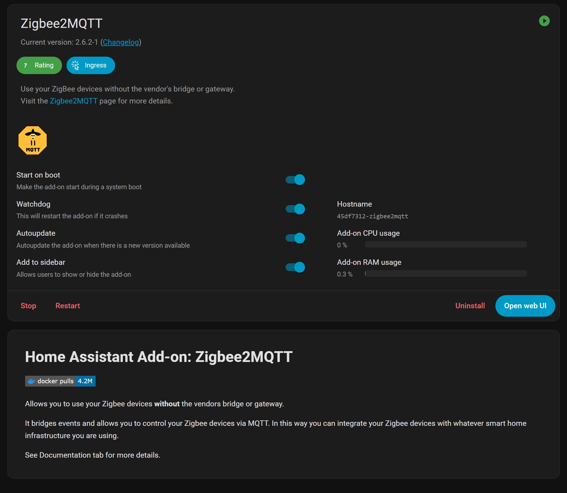

I can start and restart Zigbee2MQTT

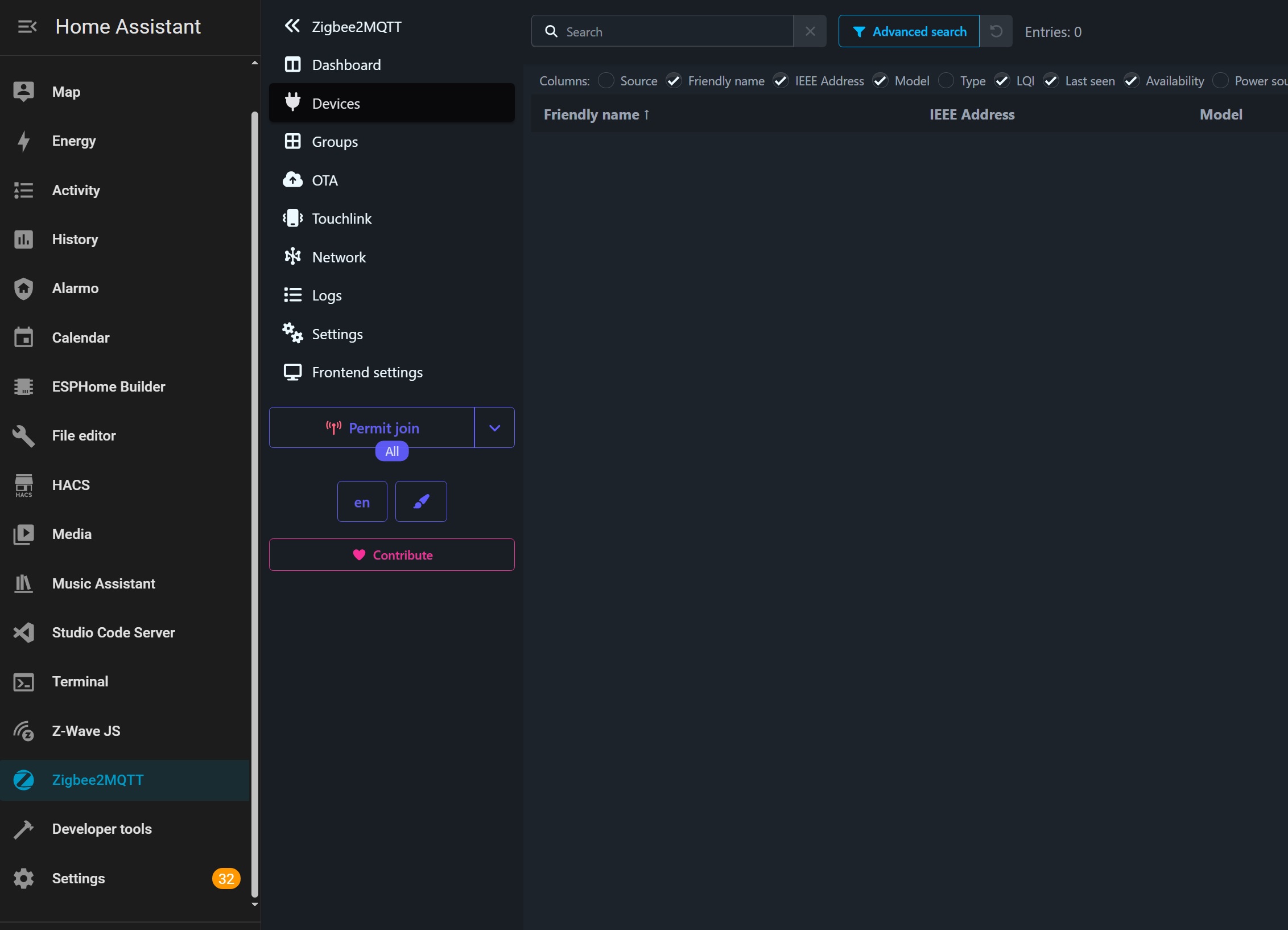

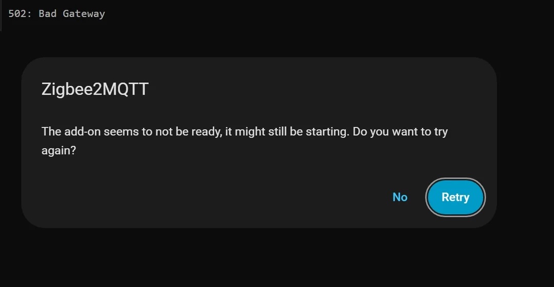

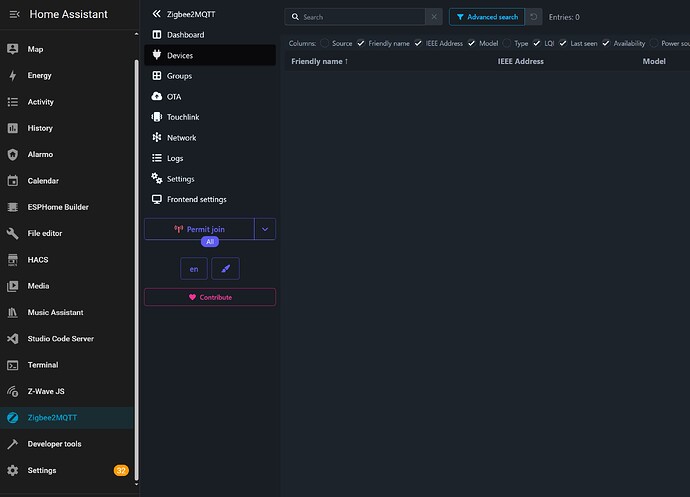

But, this is what I get when I go to the sidebar addon.

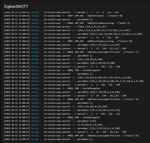

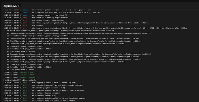

Here’s what the Zigbee2MQTT log is showing.

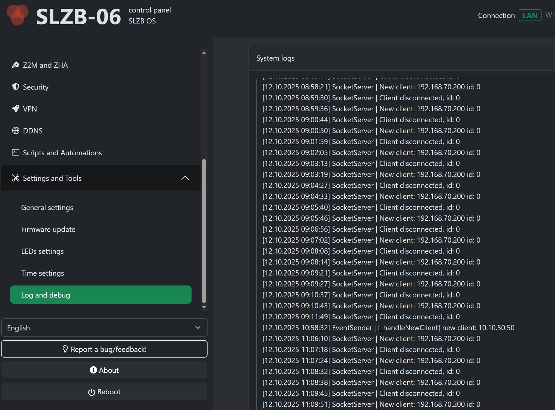

Here’s the SLZB-06 log. 192.168.70.200 is my home assistant.

503 Bad gateway means the add-on is not starting. It usually says why in the logs when you try to start it. Try disabling debug logging and see what you get in the logs then.
Thanks. Where is the debug logging setting?
You can find it in zigbee2mqtt/configuration.yaml.

Not sure what I’m looking at here…
Yeah, I’ve read through that and couldn’t find anything…
But, decided to use another channel besides 11. Switched to channel 9 and got the error message that it needed to be 11 or greater. Switched to 13 with no joy. Switched back to channel 11 and I now have a connection!!!
All my devices need to be re-added, but at least it’s talking.
