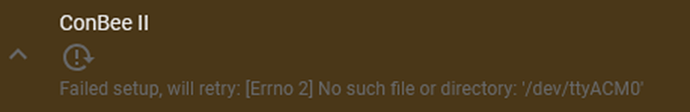

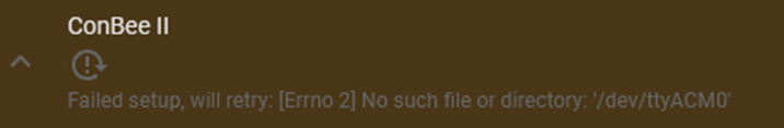

The error I get is that it cannot find /dev/ttyACM0
but it is configured
billede
I do not know what to do now, it could be a bug or no drivers for the version 2026.3.2 or 2026.2.2 (have also tried this version).

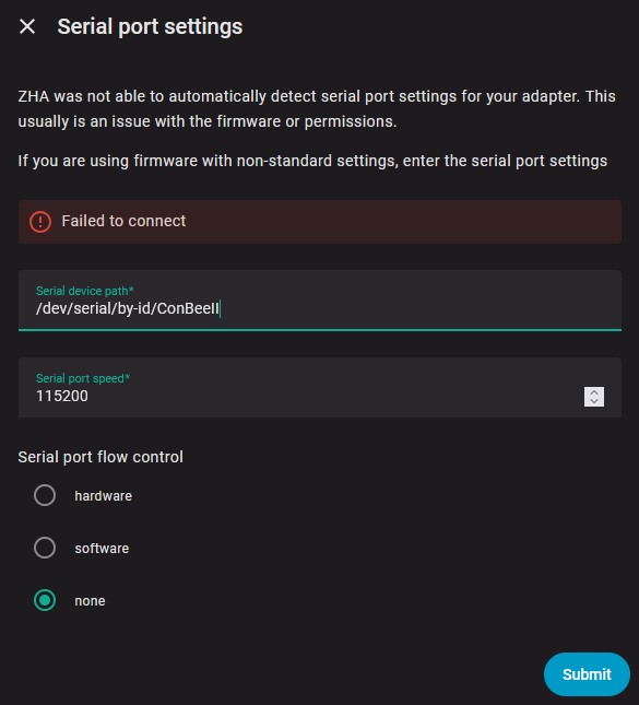

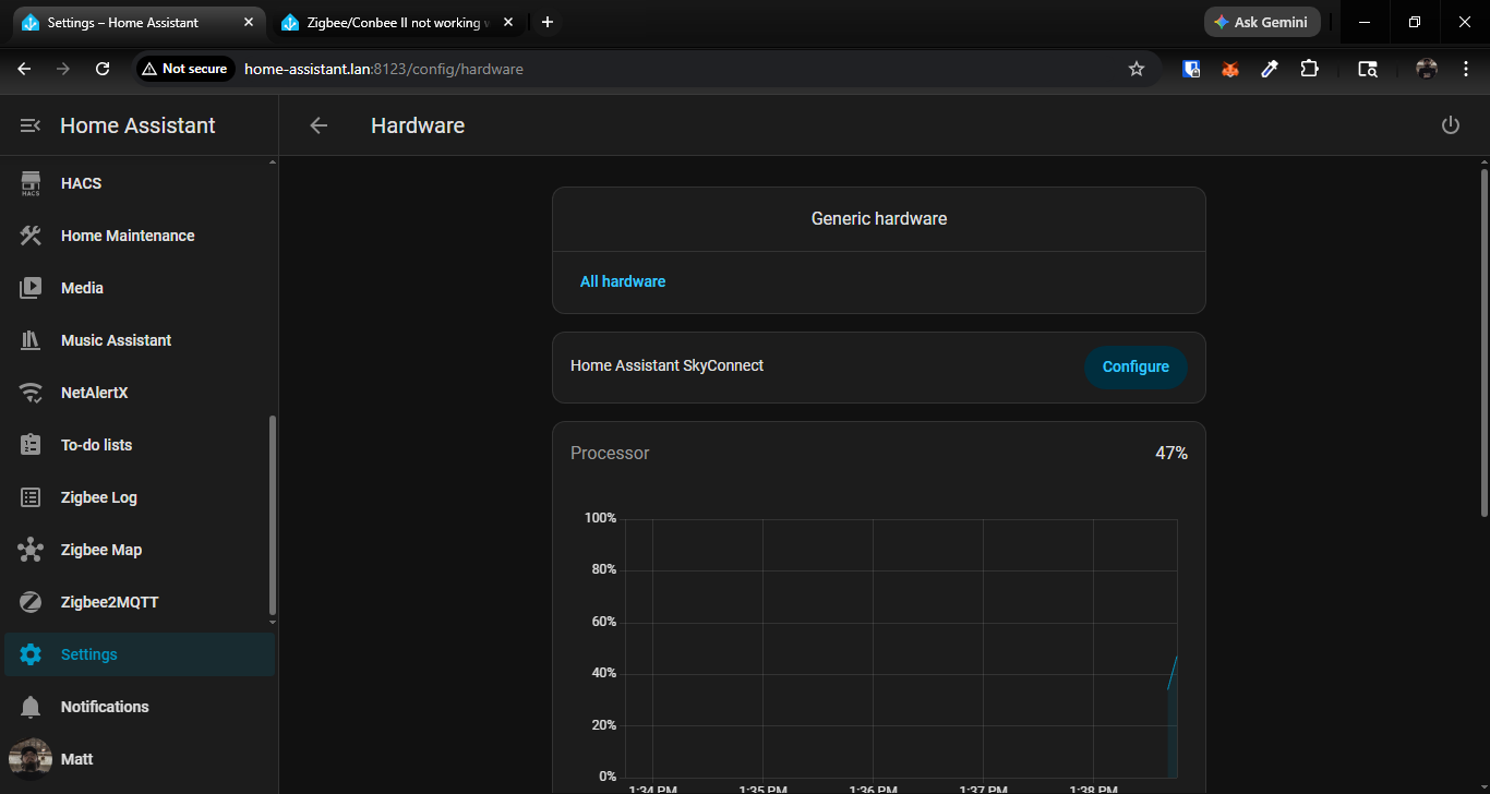

Try using the by-id path. Go to Settings > System > Hardware. Click All hardware. Scroll down and find the tty path for the coordinator that uses /dev/serial/by-id. Try using that path in your settings.
When I go to Settings > System > Hardware I will get the below window and nowhere to click All hardware.
Is this this you means:
billede
How are you running HA? I was assuming HAOS…
In HAOS, it looks like this -

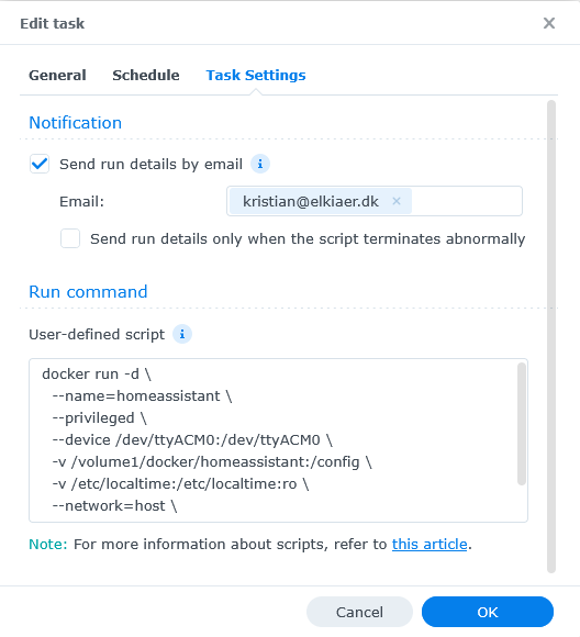

Solved - here is what I did.
I deleted all Containers.
I made a Task Scheduler with the following content:
docker run -d
–name=homeassistant
–privileged
–device /dev/ttyACM0:/dev/ttyACM0
-v /volume1/docker/homeassistant:/config
-v /etc/localtime:/etc/localtime:ro
–network=host
homeassistant/home-assistant:latest
The part “homeassistant/home-assistant:latest” is the Image with the latest version of HA

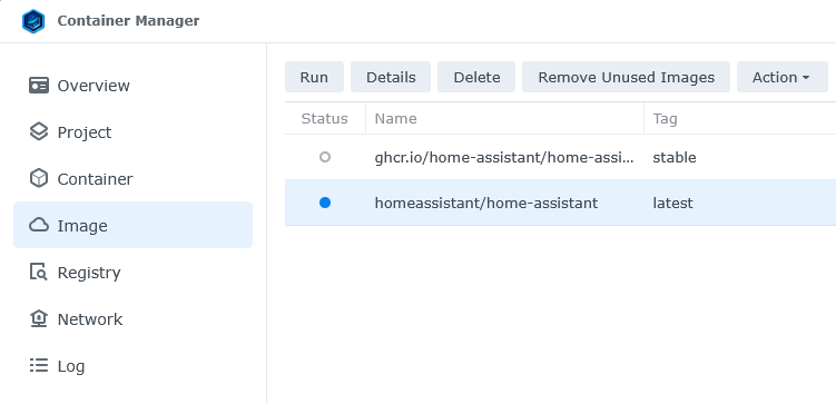

First I tried to make the Container by indicating the Image and then click Run, but that didn’t succeed for me.

The TTY ports can sometimes change internally, so it is suggested to use the /serial/by-id/ URL that always talks to your dongle by serial number so it is always right.
You can find out what that is by using:
and looking for it under all hardware, something like this:
Once you have the long URL use that instead of the ttyxxx one.

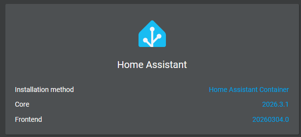

If you are using a Container installation, this is how to see the /serial/by-id/ URL:
ls -l /dev/serial/by-id
Current version is 2026.3.1
