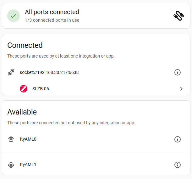

Thank you for the information. I am not using a USB coördinater (anymore) I did before.
Now I use the SLZB-06 via ethernet.
Setting are like in the screenshot below. I this ok or wrong?
I just did the update to HA 2026.09 and under the connectivity I found 2 unused serials ports:
/dev/ttyAML0
/dev/ttyAML1
Could this be a reason?
I am running Home Assistant Blue on a Hardkernel ODROID-N2/N2+
