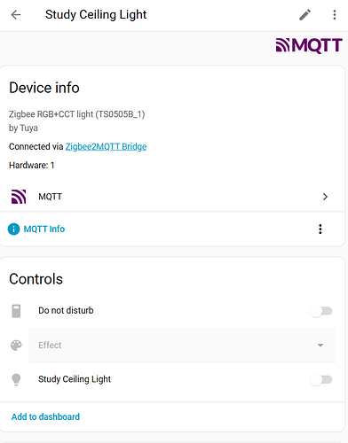

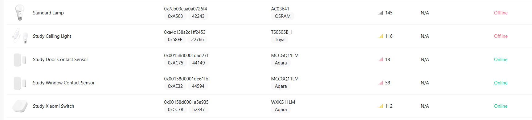

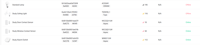

I’m in a situation where a bunch of my ZigBee devices (predominantly those with physical power rather than battery power) are not populating as online

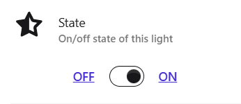

If i go into the device in Z2M interface and used the exposes tab, the device will control, but very slowly
and i get this message
The availability continues to show as offline however.
This availability is reflected (as you would expect) in Home Assistant

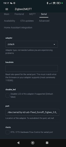

You were lucky that the coordinator picked up its previous serial device path. If you want to fix it properly, you need to change your Z2M port: config to use by-id instead. Have a look here for more info.
PS - your battery devices didn’t fail because Z2M checks in on battery devices every 25 hours or so (mains devices are checked every few minutes). You would have absolutely woken up to all devices being offline tomorrow morning.
Thankfully it’s already like that (probably from when I set it up 3 years ago :rofl:)
