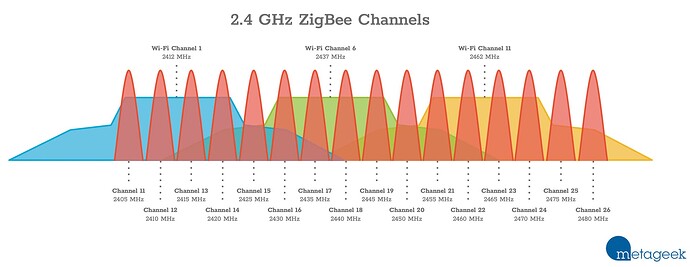

Wifi and Zigbee interference is well known
