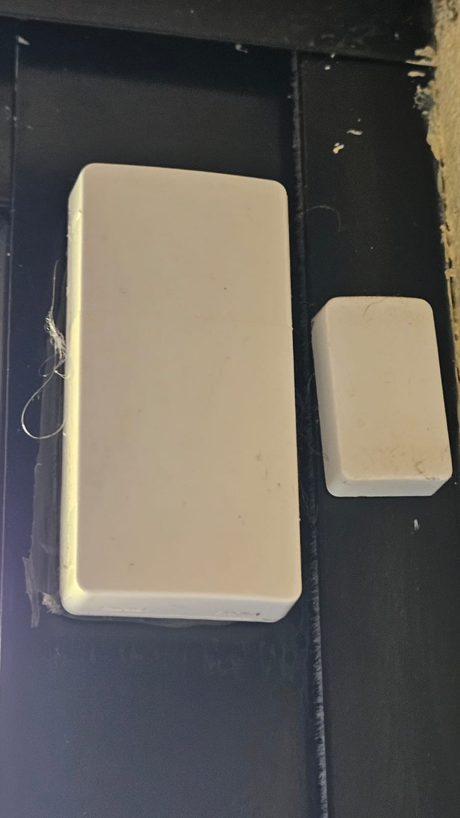

How can you tell if an already installed Zigbee sensor(s) will work with a HA USB Zigbee device? New (old) house we bought has 5 sensors already on 4 doors and 1 window.
Long press the button on the device until the light starts flashing and press the Add Device button in your Zigbee integration on HA.
The list of supported devices in Zigbee2MQTT is here Zigbee2MQTT

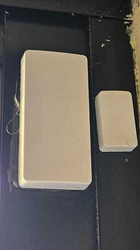

That is the main problem. I have no idea what brand this is. house came with a Climax HSGW-G8 which has Zigbee built in and with a no brand name on the sensors as shown in attached photo:
Try pairing them, if they don’t work it’s not a huge cost to change them.

How can I tell what type off sensors they are? The HSGW-G8 433MHz Vesta Wireless Alarm Panel 4G/LTE, IP and Zigbee " * Built-in Module Options: 4G/LTE, RF, ZigBee or Z-Wave" Which tells me it could be one or the other?
Take it apart.
