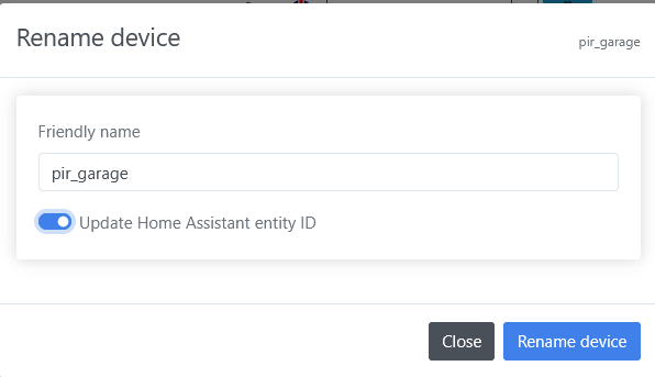

Since there are only 3, in Zigbee2MQTT, rename them with an underscore added, and then rename them back with underscore. Both times with ‘Update Home Assistant entity ID’ enabled.
Thank you! :beers:
Items are back! :ok_hand:
