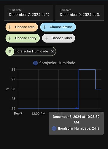

Still testing , but i see a litle trend to the soil moisture stuck ( like its green brother ) I compared it too an mi flora.
Has you see on the next picture he moves from 24 to 28% moisture when i put some good water, but the day before i had put (only) half a glass of water and he didnt move
This is the graphic off the miflora in the same vase :point_down:
Well the Xiaomi mi flora is not the best either for this measure , and the diference of arround 20 % between them is a lot, but the trend is similar, althow the miflora did move either with the first time i put a half of a glass of water.

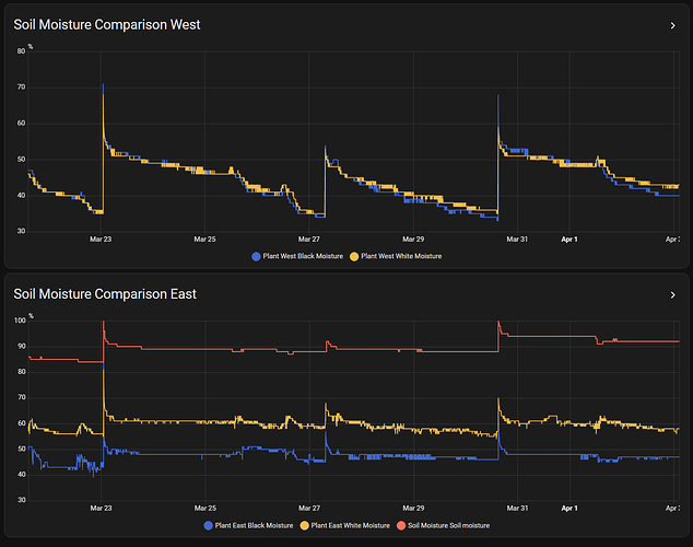

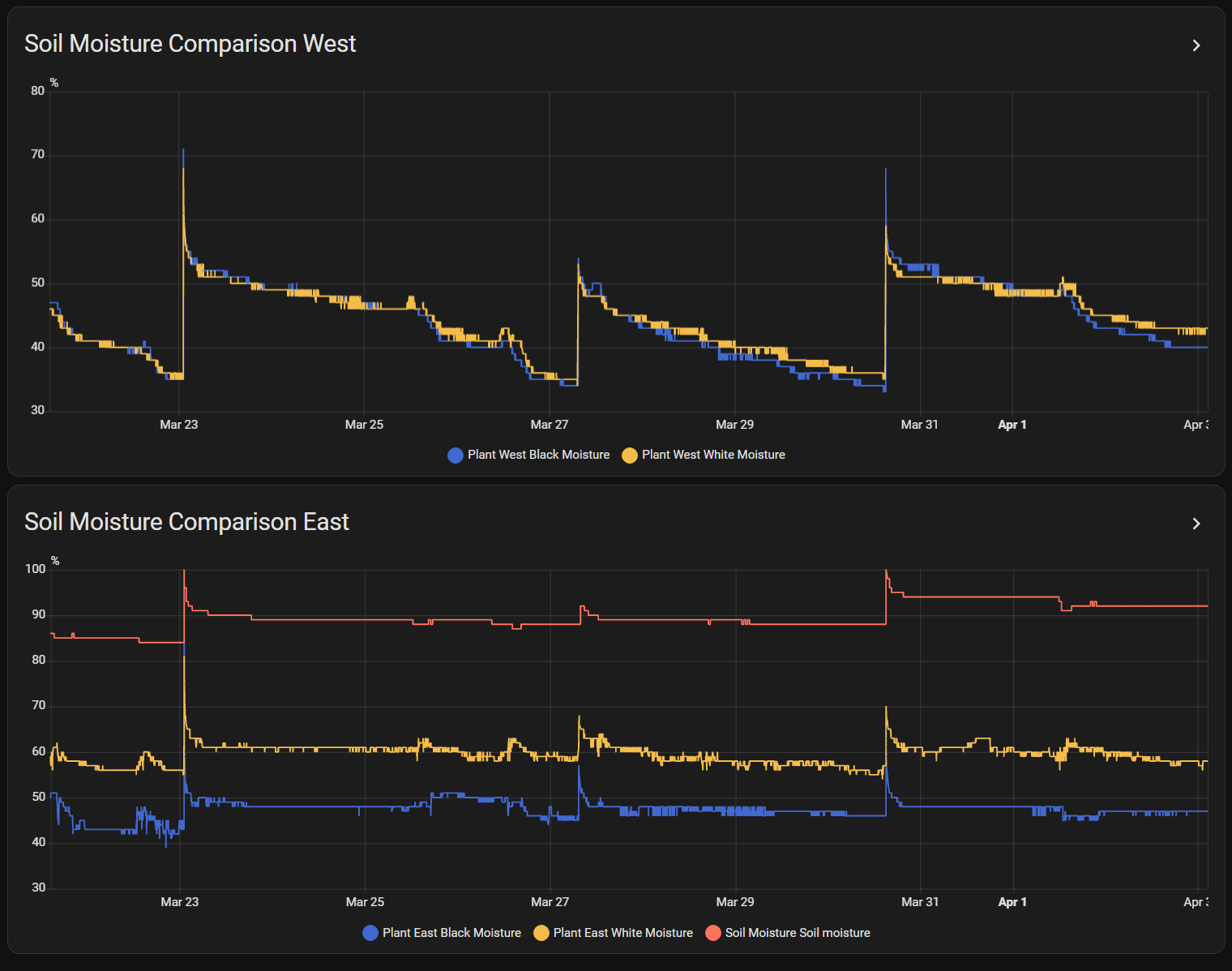

The problem with many of these consumer grade sensors is poor measurement repeatability. I have 5 soil sensors and only two show matching readings when placed right next to each other. The other three are wildly different. That said, the relative “trending” data is still useful even if the soil moisture isn’t completely accurate. For example, I can tell that the moisture level is decreasing and when it gets below the minimum over a week’s time, then it’s time to water. But if I used another sensor’s absolute reading one day and then another sensor the next, it would be useless.
