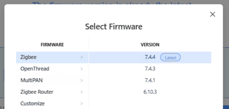

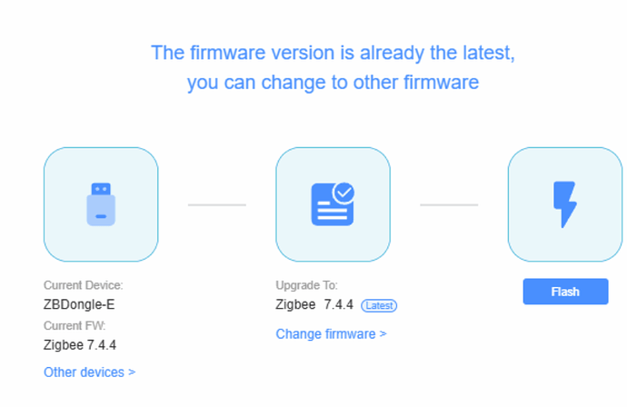

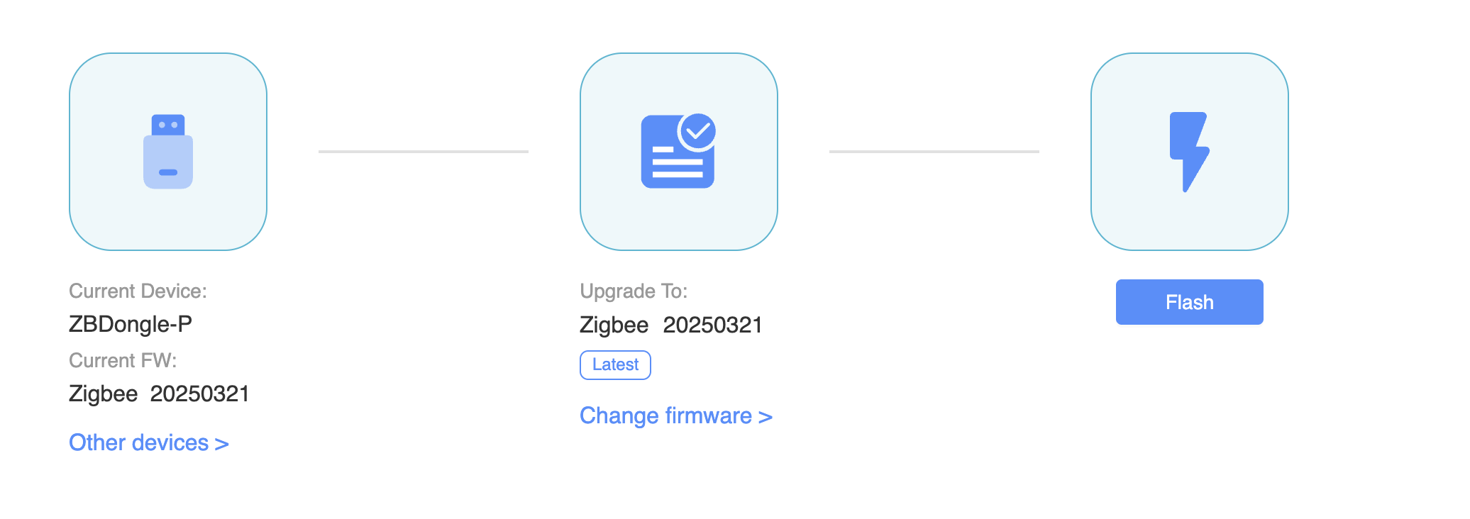

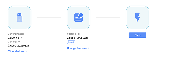

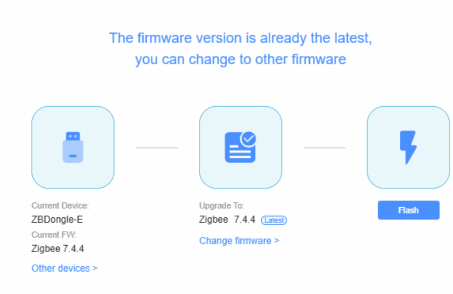

Im unsure how to understand what firmware im putting in, last update i just used the automatic tool from sonoff web. Will see if i can extract some info from there.
If you’re talking about this, that link has gifs to show you what you should be seeing, including a “Current FW” where it lists what you’re running:
not exactly the same but similar?
Ok, then you’re definitely on zigbee coordinator firmware.
