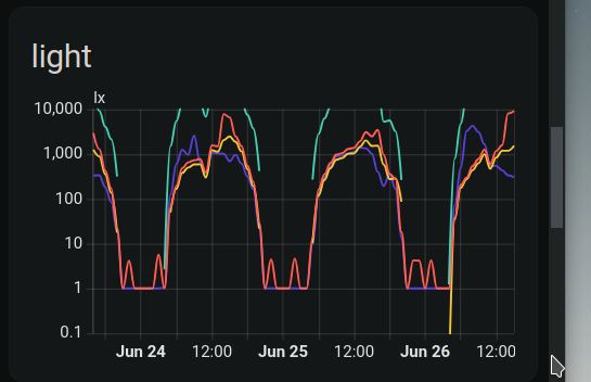

These worked for my plants with Z2M.
https://www.aliexpress.us/item/3256807698597755.html

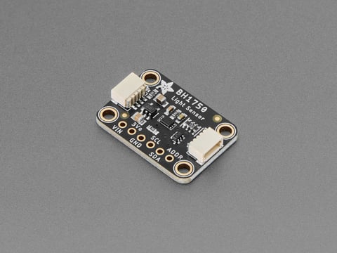

If you’re up for building an ESPHome based one, the BH1750 sensor will apparently measure up to 100k lux. Here’s an adafruit version:
Looks good enough, although i would’ve liked a sensor that can measure broad daylight with no issues. 100k would be nice.
