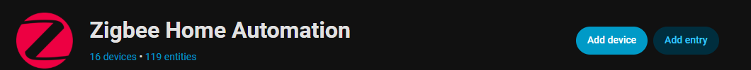

Ahh - not sure how to answer that - I have no real idea.
I use this under integrations
Thats where all the zigbee devices I have tried (until this switch) live and work.
I am using a Sonoff Zigbee 3.0 USB Dongle Plus and some Ikea Tradfri range extenders to move the signal from my garage (where HA is) to the house.
Apparently this is ZHA. I may not understand the difference.

You re using zha integration.
There is zigbee2mqtt addon. But this require mosquitto addon to be installed, started and to work.
You can use only one or zha as integration or zigbee2mqtt and mosquitto addons for controlling zigbee devices.
