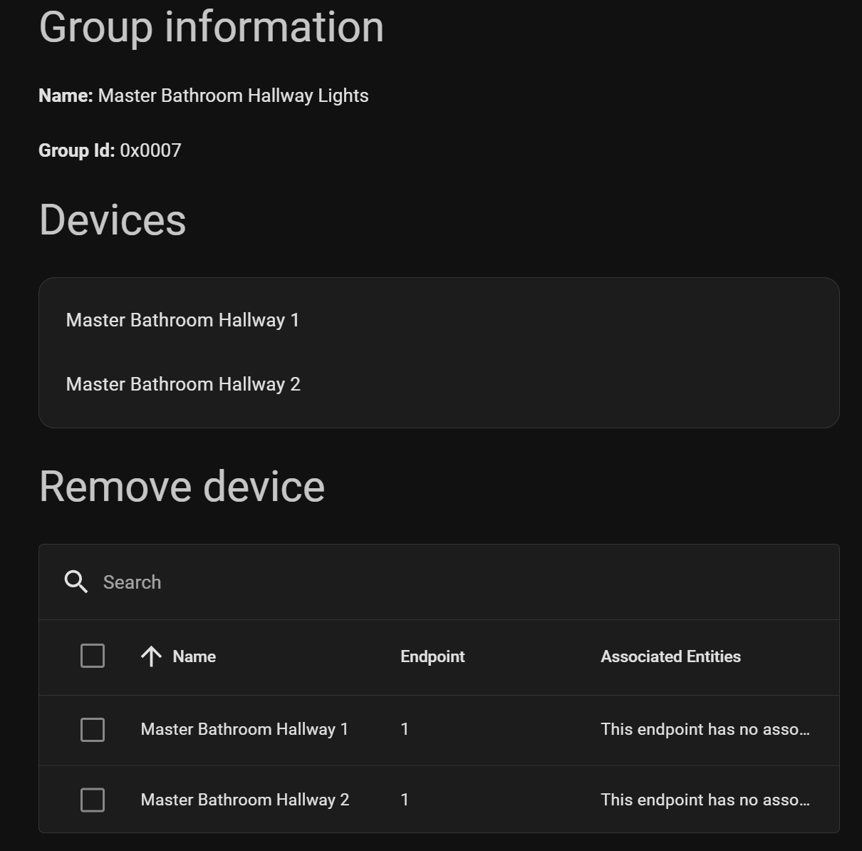

Zigbee light group
I have two lights in this fixture. Here’s the Zigbee group:
I checked, and these lights aren’t listed in my other Zigbee groups either.

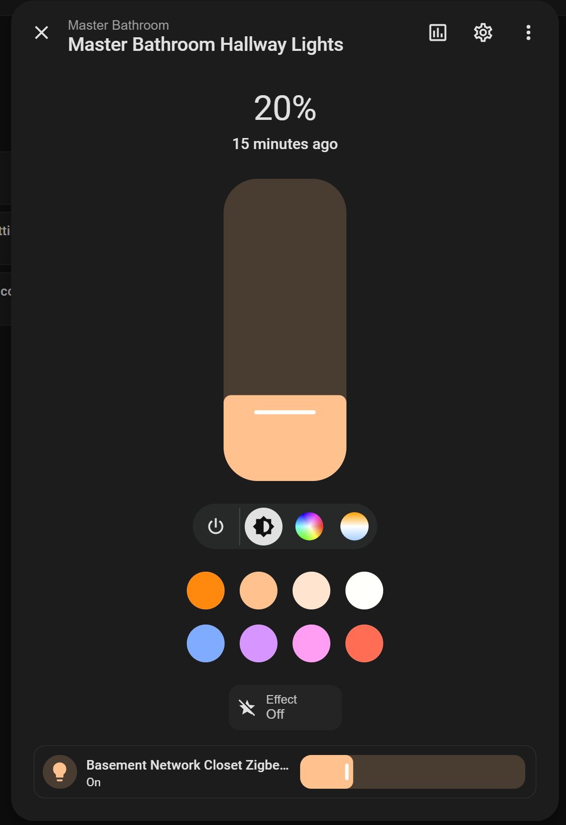

Zigbee light group
Looking at the Zigbee light group, I thought I might see more details about how the lights keep turning on, and this is what I saw: “turned on”. It doesn’t tell me why, but it’s clear the group itself is turning on.
turned on

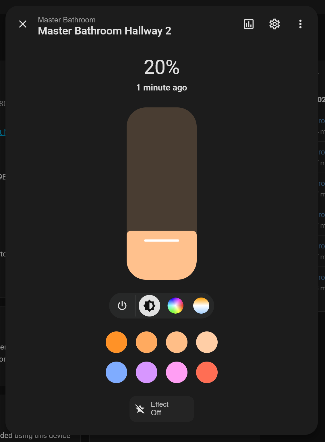

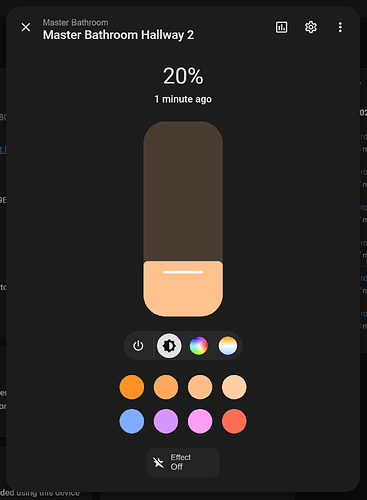

Doing some more research, it appears it’s not both hallway lights turning on, but one of them:
I think the state of this light isn’t changing.
I actually turned it off in Home Assistant just before taking that screenshot, but it’s still showing on. That’s probably the issue. This light is defiant, so it keeps making the Zigbee group’s state change to “on” even if the other light isn’t on.
I tried a bunch of commands like changing the brightness and color, but the numbers in Home Assistant didn’t change.
