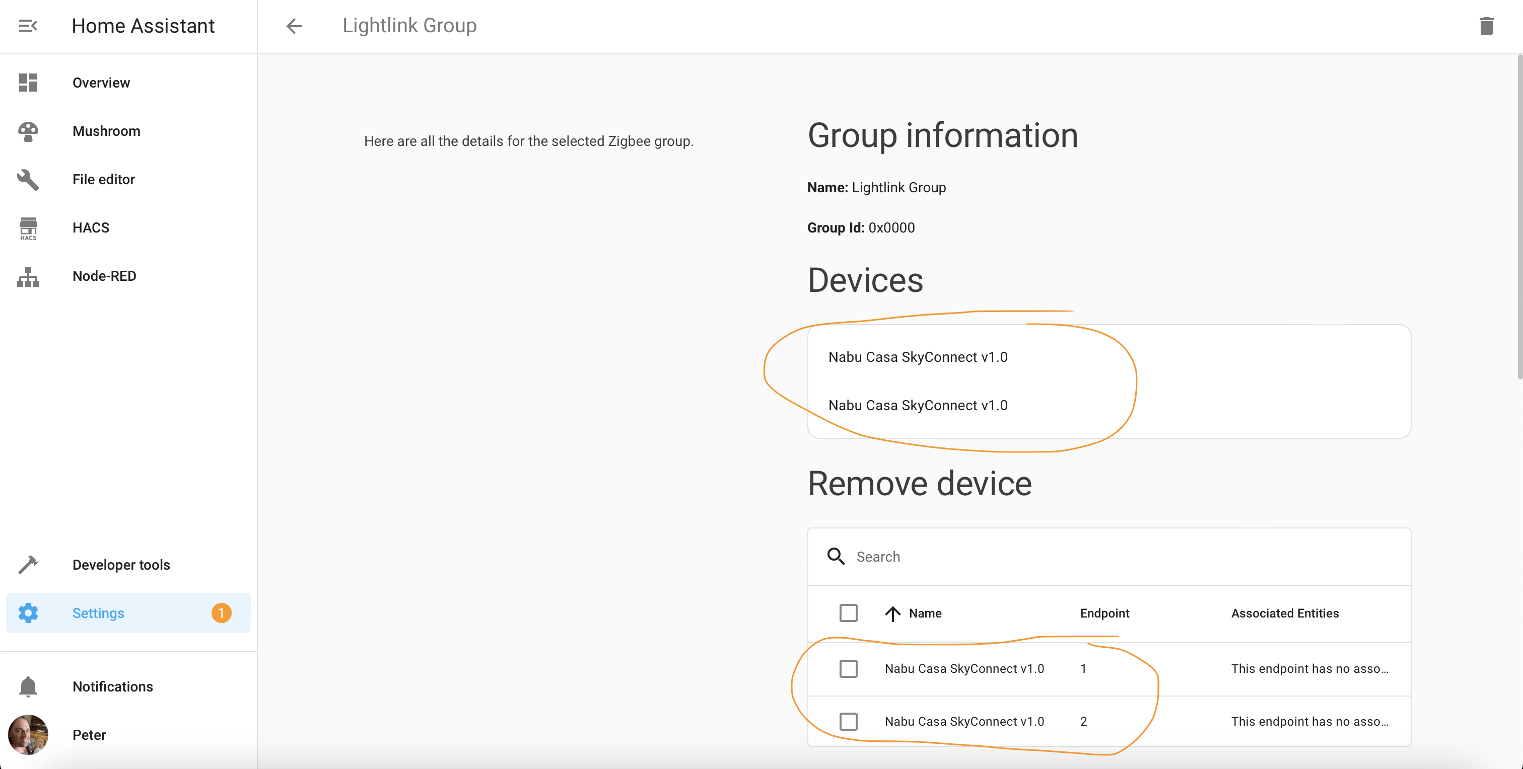

I notice in Settings → Devices & Services → Zigbee Home Automation → SkyConnect v1.0 (Configure) → Groups → “Lightlink Group” there appears to be 2 instances of the coordinator, could this be causing an issue? I don’t know what this group is even for or who made it. It’s the only group listed. (see screenshot)
