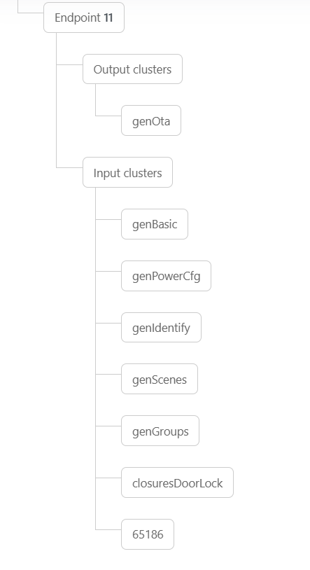

I took a look in MQTT (se picture) and I am wondering if the correct clusters for changing pin is even exposed? If that is the case its not working?

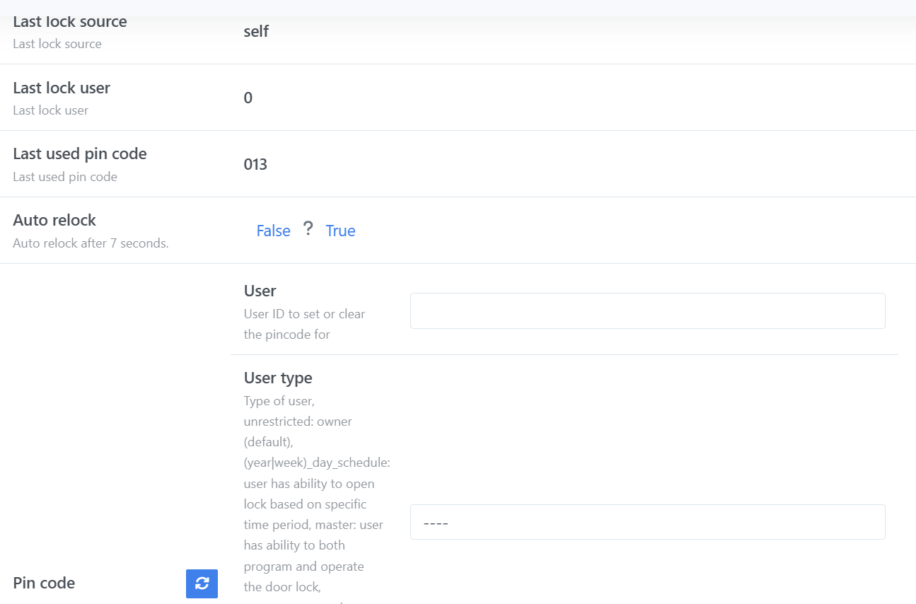

Try clicking on the “Exposes” tab and see if that shows you a PIN interface? This is what I see…
Yep it does
To be transparent. I have before tried to change pin here, but then I also got the timeout error. So its a little bit puzzling that when trying to change pin, its not working, either with from your integration, or in MQTT itself.

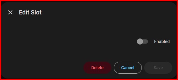

I was able to install Lockly via HACs. However, when I add the “Lockly” lovelace card and try to “Add slot”, I don’t see any fields for adding the “Name” or the “pin code” (see image attached).
Any ideas what I might be missing there?

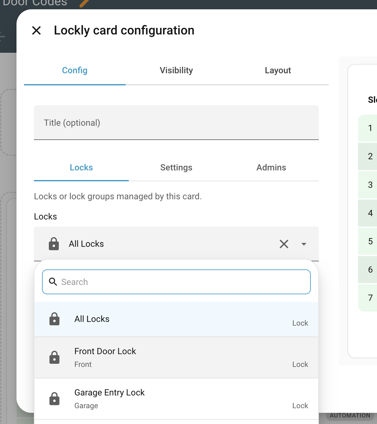

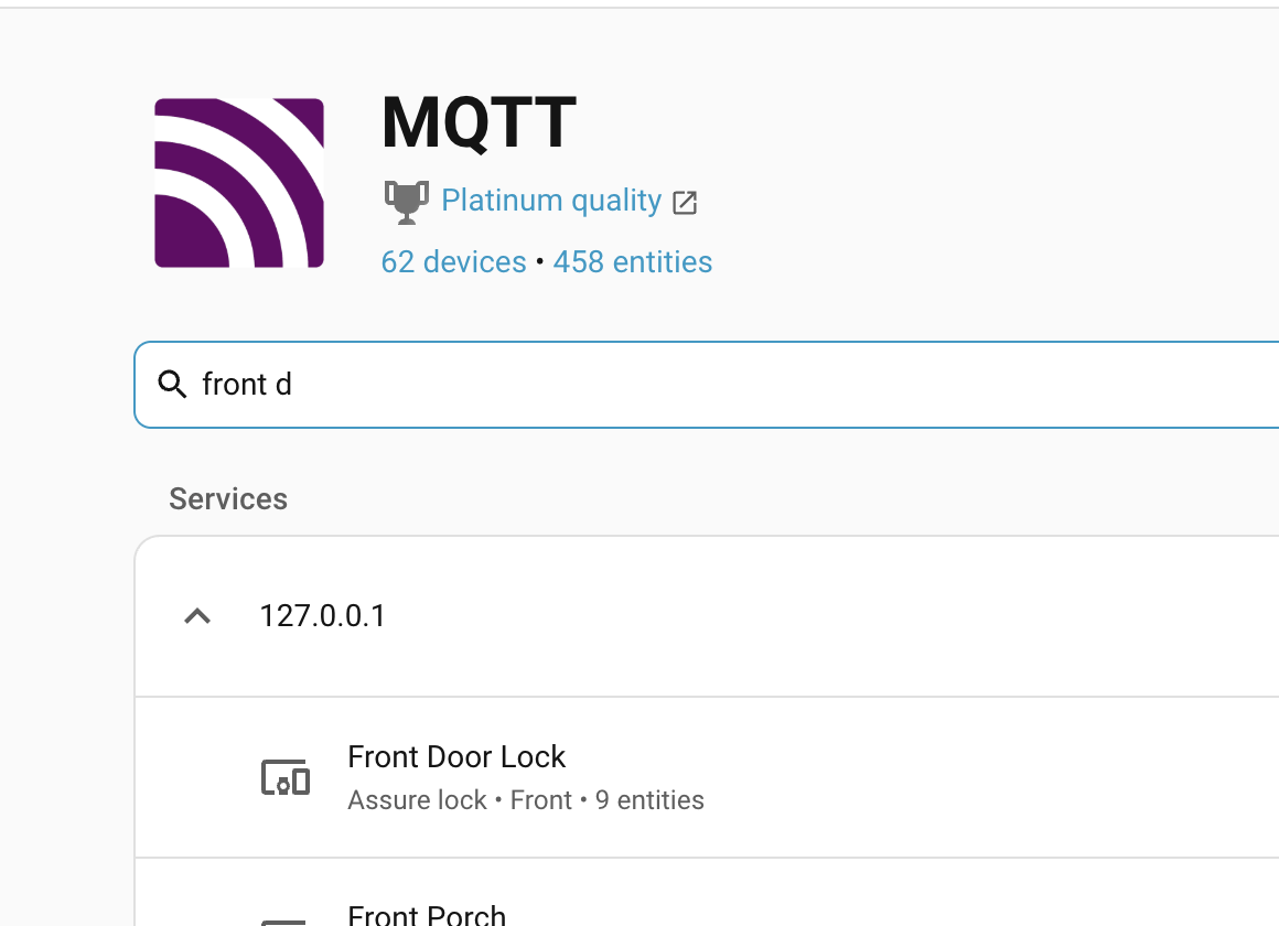

Hey @fresnoboy! Do the locks show up in your MQTT integration in HA? If they show up there, then they should also show up in the dropdown in the Lockly card config. Here are a couple of screenshots- first from my MQTT integration showing the front door lock, then from the Lockly card config where you can see it showing up in the dropdown. lmk what you see!

@bhaha - this is a bug! I’ve filed it here: Edit Slot dialog shows no Name/PIN fields on HA 2026.9: card assumes ha-input is already registered · Issue #177 · bharat/homeassistant-lockly · GitHub
It loos like a new issue with 2026.9 and I’ll get a new version of Lockly out with the fix asap. Meanwhile, as a workaround try opening the card’s edit dialog once (three dots, Edit) should register the element for that page load, after which Edit Slot will show the fields until the next full reload and lmk if that works.
@bhaha - I pushed a fix but haven’t cut a release yet. Can you test it out for me?

@bhaha quick update: the fix is now in a proper release, v2026.10.13. If you
didn’t try the commit install, just update Lockly through HACS, restart Home
Assistant, and hard refresh the browser. The Edit Slot dialog should show the
Name and PIN fields again. I’ve verified it on 2026.10.1 here. Let me know
either way.
