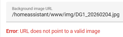

hi
whats the correct image type?
I tried jpg and png
or is the URL wrong?
you use “local” instead of “/homeassistant/www”

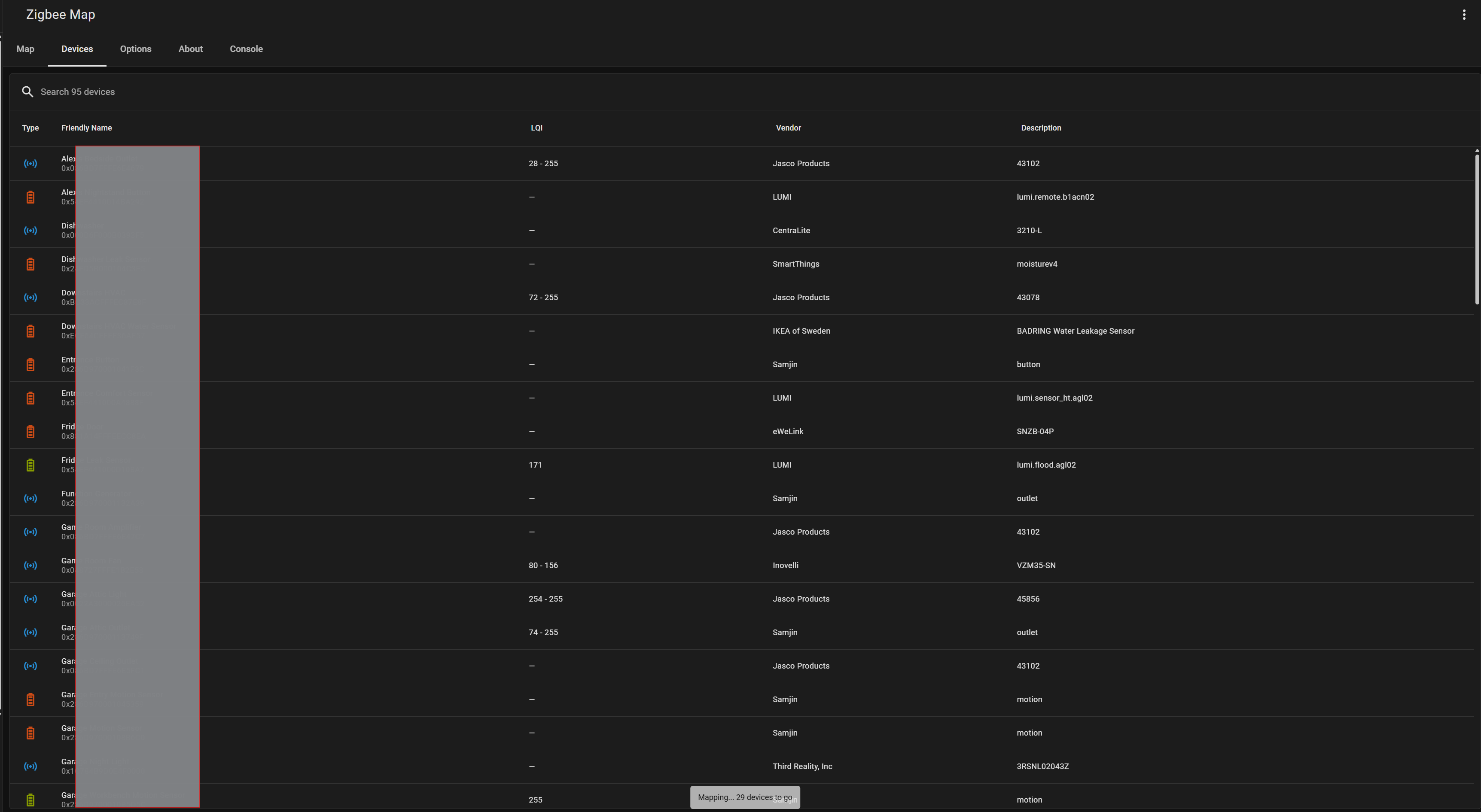

It’s fun to watch the map form - reminds me of popping popcorn, but I was wondering whether there was away to have it persist - and just update when viewing in the interest of time.
Also, I noticed it said something about probing 40 or so devices, and in the log I think I counted 46, however I have 95. I did not count the ones shown on the map, but my guess is all 95 are there. Is the probing only for routers?
This will be fun to hunt down, but I was unaware so great to see this feature. I randomly see log entries about unknown devices and wonder whether something is not working right or it is devices from my neighbor.

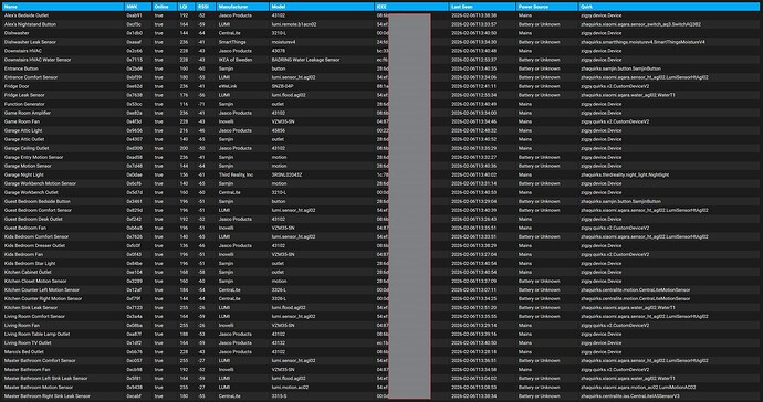

To make up for some shortcomings of ZHA, I use this table a lot when troubleshooting issues. I was wondering whether a few additional - user selectable - columns could be added to your device list. The partial snapshot below shows all the columns that are available in this table:
(credit: custom:zha-network-card by dmulcahey - I believe one of the awesome ZHA developers)
The online column is an easy way to find devices with issues. NWK is how the logs reference the device so it is useful to figure out what device the logs are referring to. RSSI is helpful in the same context of when LQI is. IEEE would be nice in its own column for readability. And… it would be awesome if the data could be exported in a comma delimited file (csv) - but that is me being greedy :smiley:
I have lots of space to fill with more data :slight_smile:
This is actually one of the reasons I like Z2M: my Zigbee mesh keeps humming along even when I restart HA. And MQTT is awesome for creating virtual entities and devices through its discovery topics. What I really don’t like though, is that my Zigbee devices end up listed under the MQTT integration together with unrelated Wi‑Fi devices that also use MQTT :angry:
Since I get all the information needed to build the map in a single call to ZHA, I can build it instantly. I just reused the Z2M mechanism that queries each device one by one, and the “popcorn effect” exists purely because of that. It’s actually mesmerizing to watch the map come into existence, but I get it… we live in the age of speed and shrinking attention spans. I’ll try to improve this.
The app keeps a processing queue. It starts with 1 (the coordinator), so initially you’ll see “Mapping… 1 device to go”
After the coordinator is queried, it is removed from the queue and all its neighbors are added. So if the coordinator has 25 neighbors, the message becomes “Mapping… 25 devices to go”
As it processes each neighbor, it discovers more devices and updates the queue accordingly. Sometimes the number goes up. There’s no way around this with Z2M.

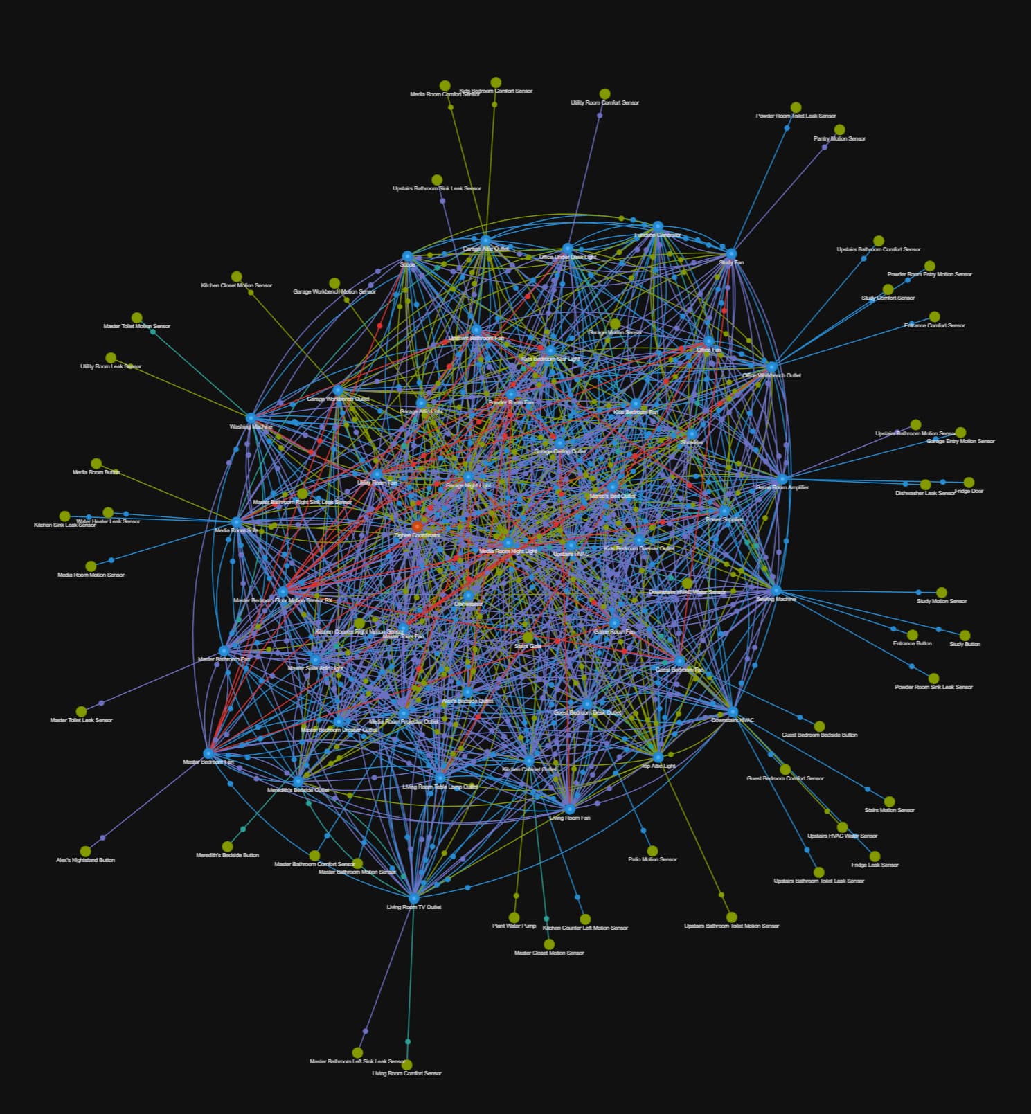

This looks like a very healthy Zigbee network, very few reddish lines. Nice!
I probably need to add something about this in the “About” tab, or maybe just hide the warning message entirely. This has come up earlier in the thread. These aren’t your neighbor’s devices, but are old devices that used to be part of your mesh but are now gone. Ghosts that are angry you removed them and have come back to haunt your mesh! :ghost:
You are right, the device list needs some love: more columns, maybe some grouping, etc. I’ll see what I can.

Most are from a Sonoff mmwave presence sensor that I am not even using. It appears that the red lines are often caused by specific devices. Whether that is true or not, I’ve been replacing them with alternative solutions. Seems like the strategy is working… for now, lol. Just jinxed myself!

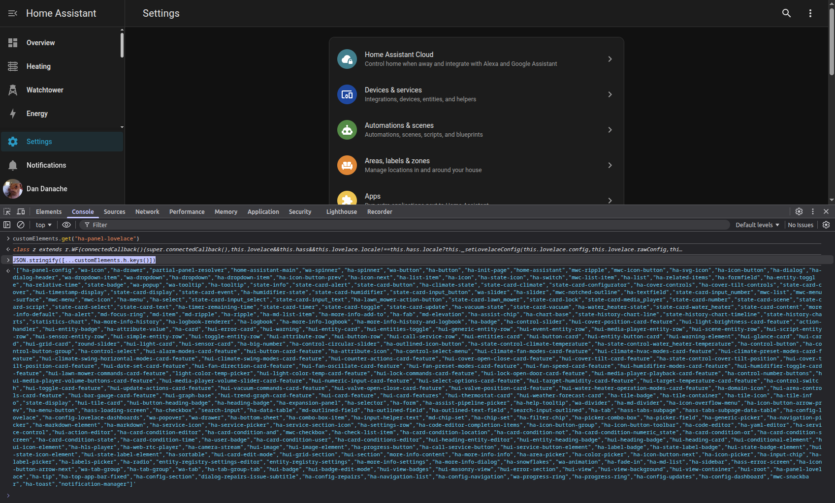

This is weird. try this:
  1. Open Home Assistant UI in your browser (any page)
  2. Press F12 on your keyboard to open the browser console / developer tools
  3. Go to the Console tab
  4. Type the following lines, one by one, in the console prompt (>) then press Enter:
    > customElements.get("ha-panel-lovelace")
    > JSON.stringify([...customElements.h.keys()])
  5. Paste the output here. From the looks of it, for some reason, customElements.get("ha-panel-lovelace") returns undefined on your browser.
This is how it looks on my Brave browser:
Thank you for your help!
Edit: does it work on your mobile in the Companion app?

Here you go.
undefined
'["ha-panel-config","wa-icon","ha-drawer","partial-panel-resolver","home-assistant-main","wa-spinner","ha-spinner","wa-button","ha-button","ha-init-page","home-assistant","action-handler","wa-animation","ha-fade-in","ha-svg-icon","ha-icon","mwc-ripple","mwc-icon-button","ha-icon-button","ha-md-list","md-focus-ring","md-item","md-ripple","ha-ripple","ha-md-list-item","ha-user-badge","ha-sidebar","h…'
As you already anticipated, the first command returned “undefined”.
I had to install the Companion App first… but sorry to say: it shows the blank page there as well.

I am also having this issue. Same error. Same undefined on:
I tried to shave a few KB off the JS files by dropping the dependency on lit and relying on the version bundled with the HA front‑end.
It seemed like a glorious idea at the time, but looks like the results are hit and miss. And since we don’t treat the kilobyte as sacred anymore like we did in the old days, I’ll add the dependency back in when I get a bit of time.
