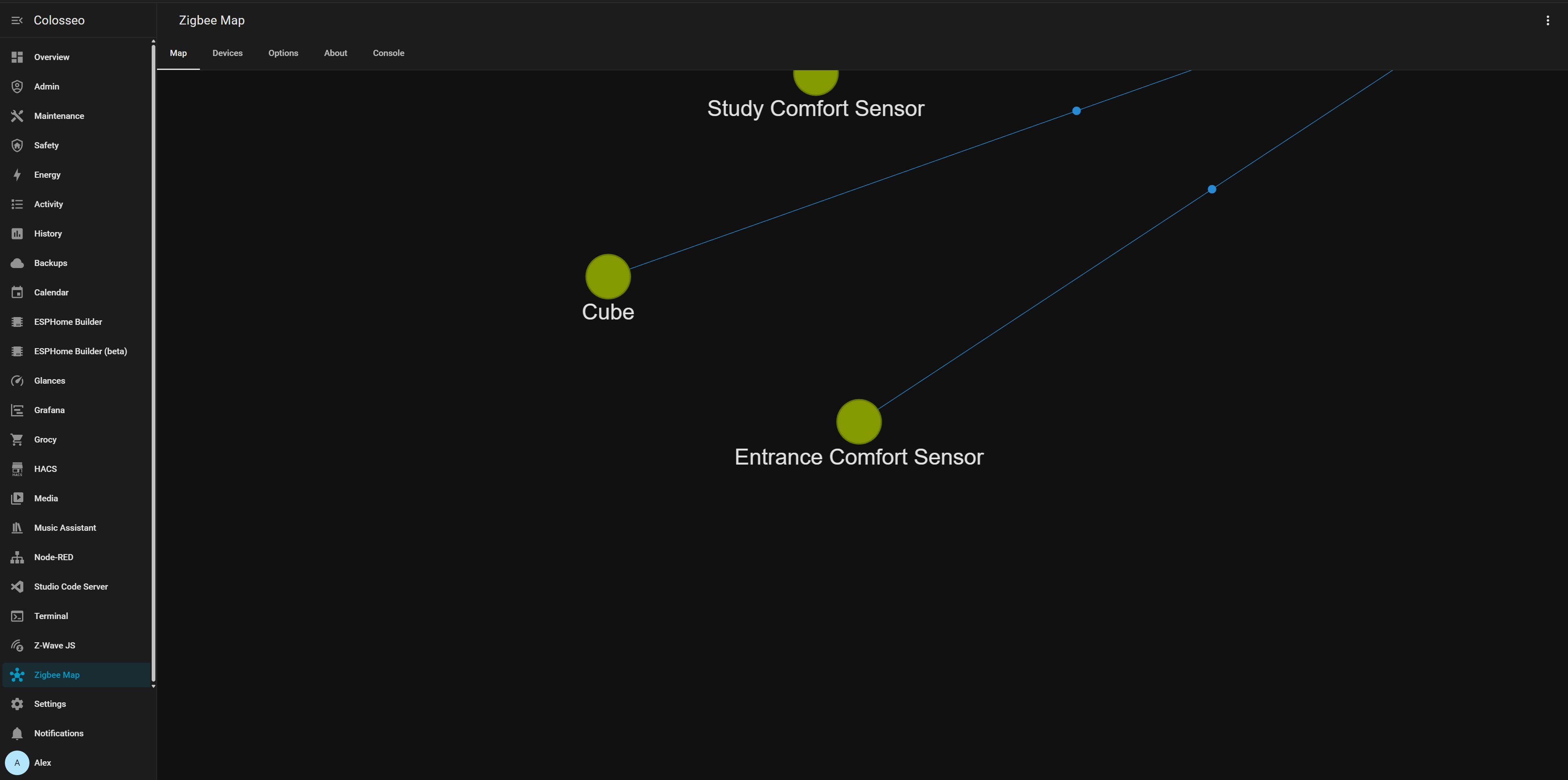

The Devices tab already has search, grouping, sorting, and color‑coding, so even big networks should be easy to navigate. Clicking a device jumps to it on the map. I like the zoom effect, but I’m starting to think that highlighting the node might actually be more useful.
If the disconnected device is battery‑powered, its last hop is always its parent.
If it’s a router, there’s no way for the coordinator (or any other node) to know the last path. Each node only knows the next hop; once it forwards the message, the rest of the route is outside its view.

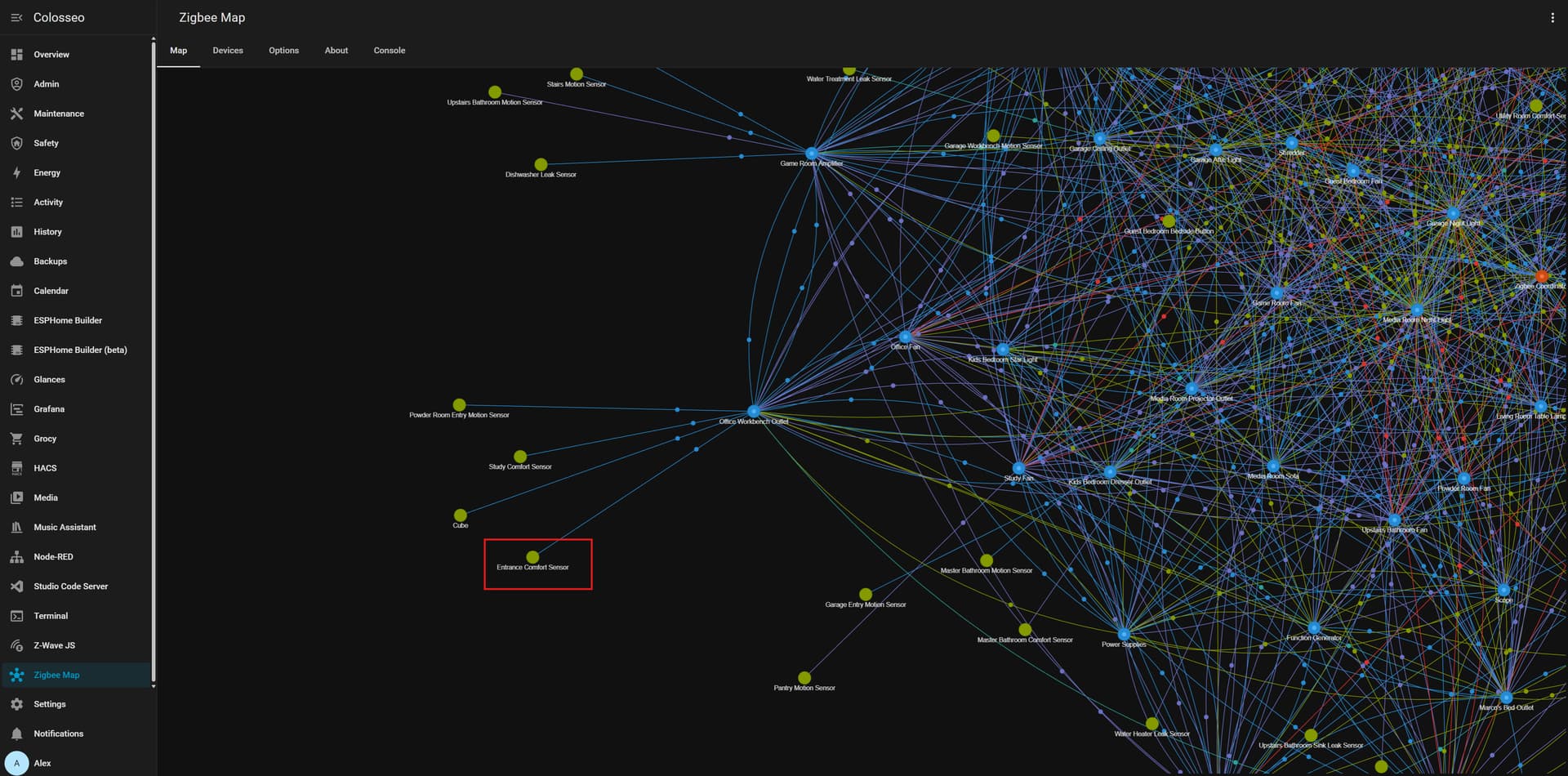

Nice! Somehow I had missed that. I like the zoom but always have to zoom out to benefit from the view. Maybe zoom in less and somehow highlight the device?

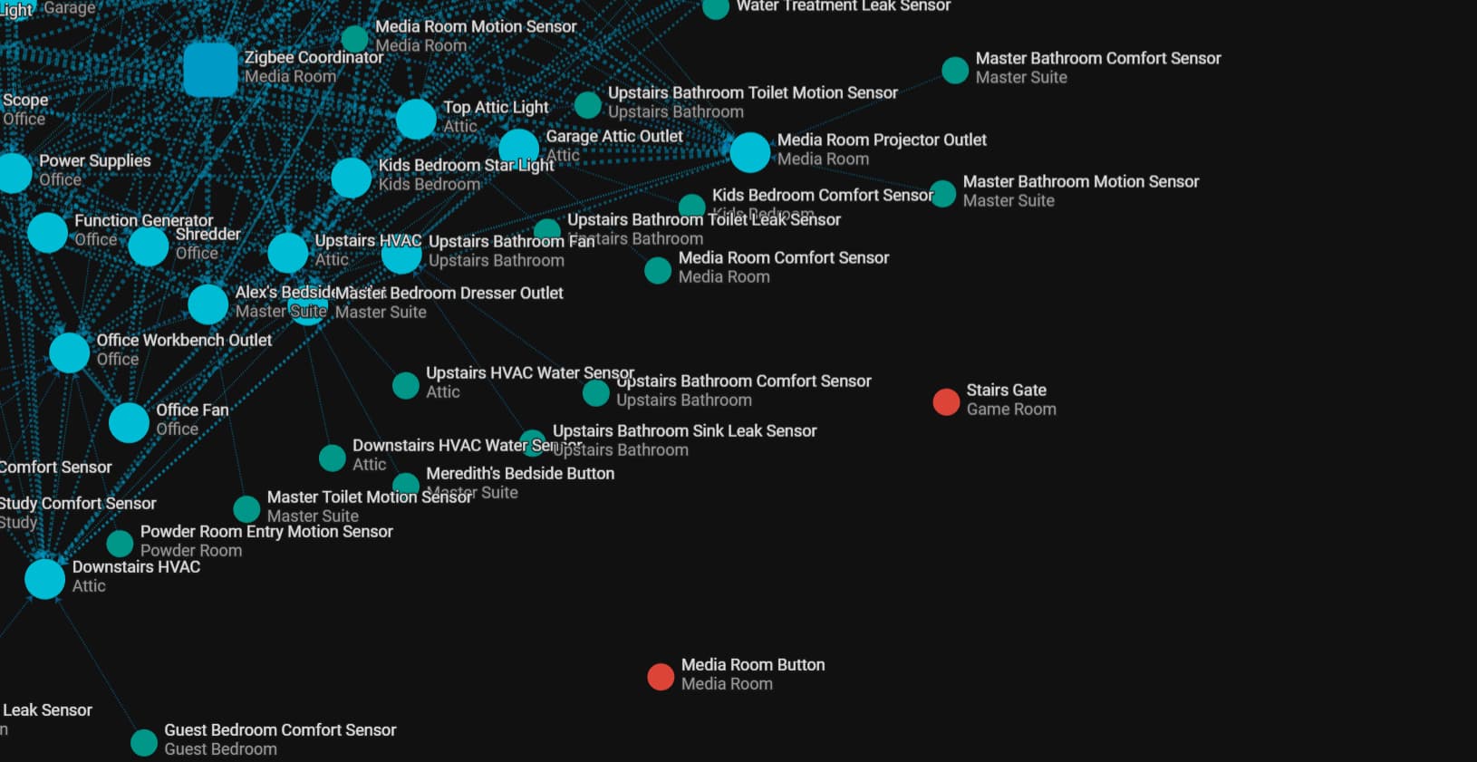

This is what it showed me on a 4K screen:
While this would be good enough to both see the device and its parent.
Yeah, I noticed that most (all?) battery powered zigbee devices are connected to only one parent. The one I was troubleshooting was a battery operated motion sensor that did not appear in the map. I can’t recall whether I checked the device list. Maybe showing it on the map in red, with a red dotted line to the parent might be useful to spot battery powered devices with issues?
The stock ZHA map visualization shows dead devices like this - without parent - so hard to troubleshoot (assuming the offline node is actually ok).

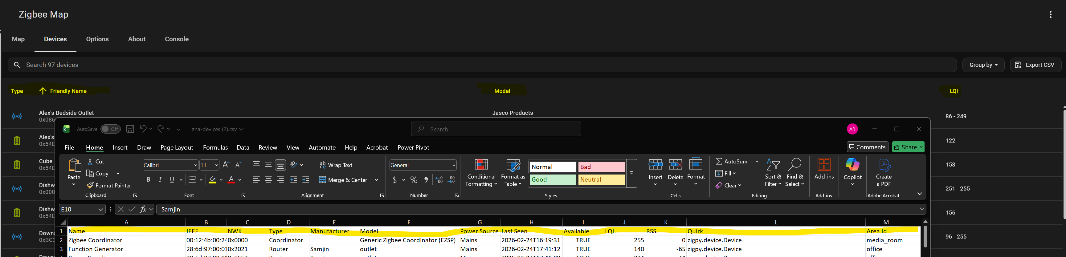

On another note, the (awesome) CSV file has columns that would also be great to have in the live view - and ideally shown the same way (each thing in its own column).

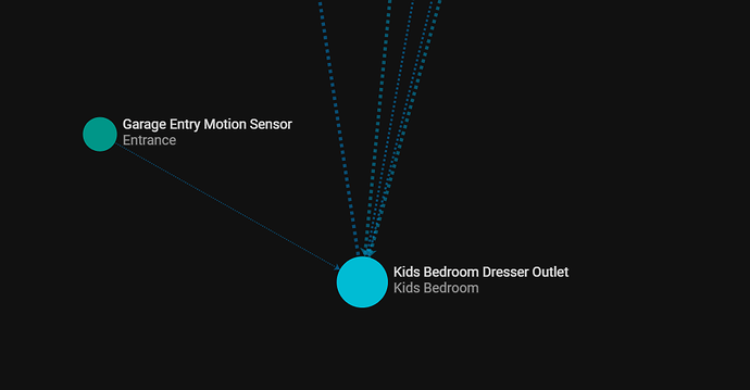

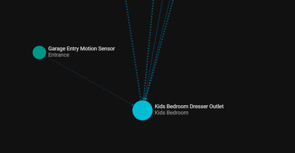

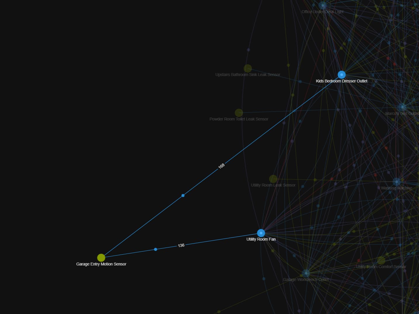

The motion sensor is battery operated and it is my understanding it can only have one parent, however in the map it shows 2. Given it occasionally dies on me, when I replaced the battery this morning, I added the sensor via the nearby Utility Room Fan zigbee switch. It appears it added the route, but did not replace the prior one… or is this a map issue?
I checked the Console output but no battery operated devices appear there.
The ZHA map shows the sensor connected to the dresser outlet - not what I selected when I repaired the connection.
Looks like both “Utility Room Fan” and “Kids Bedroom Dresser Outlet” currently think that “Garage Entry Motion Sensor” is their child. This can happen for a variety of reasons; for example, if the battery‑powered device is re‑paired while its previous parent is powered off and doesn’t receive the “goodbye” message.
In most cases this resolves itself over time, as one of the repeaters will eventually drop the battery device as its child.
I should probably add an option to query battery‑powered devices on demand so we can see who their actual parent is.
So in short, it’s not a bug nor issue when the node has 2 routes.

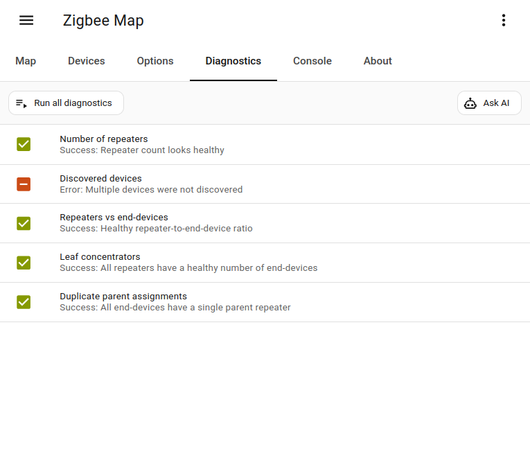

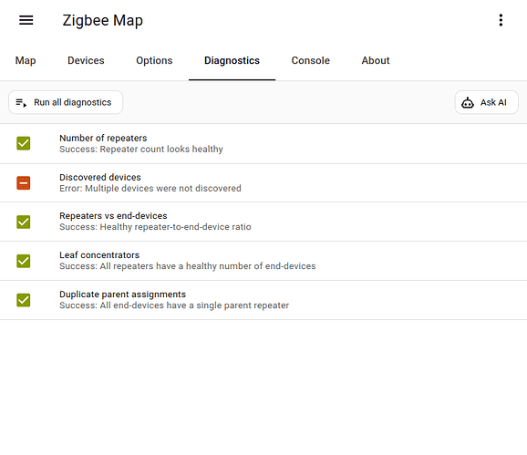

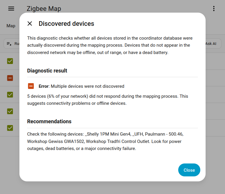

The new “Diagnostics” tab is now available in Zigbee Map, offering guidance and insights into your Zigbee network. The framework is in place, now looking for help from experienced users to expand the diagnostic library.
Currently implemented diagnostics:
Diagnostic details example:

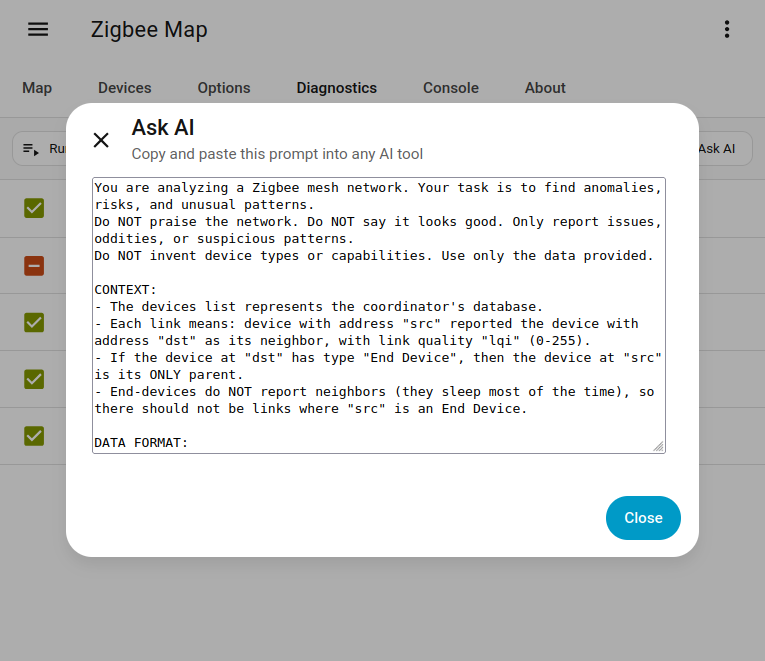

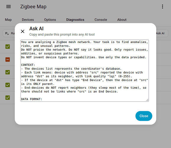

I’m no prompt‑engineering wizard, and AI answers should always be treated with a healthy dose of skepticism, but there’s now an “Ask AI” button that builds a prompt for you to paste into any AI assistant you choose:
Can I get my “powered by AI” badge for this project now? :slight_smile:
