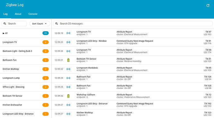

Released version 2.0.0 with the following new feature:
Added
  • Add Zigbee Log panel
  • Refactored the HA custom extension (for GPM install)
To manually install the Zigbee Log panel:
  1. Download the panel script: zigbee-log-panel.js
  2. Place the file in your Home Assistant instance’s config/www directory
  3. Add the following snippet to your config/configuration.yaml file:
     panel_custom:
       - name: zigbee-log-panel
         url_path: zigbee-log
         module_url: /local/zigbee-log-panel.js
         sidebar_title: Zigbee Log
         sidebar_icon: mdi:list-box-outline
  4. Restart Home Assistant
  5. The Zigbee Log panel should now appear in your sidebar
Click here if version 2.0.0 doesn't appear in the 'About' tab after updating.
