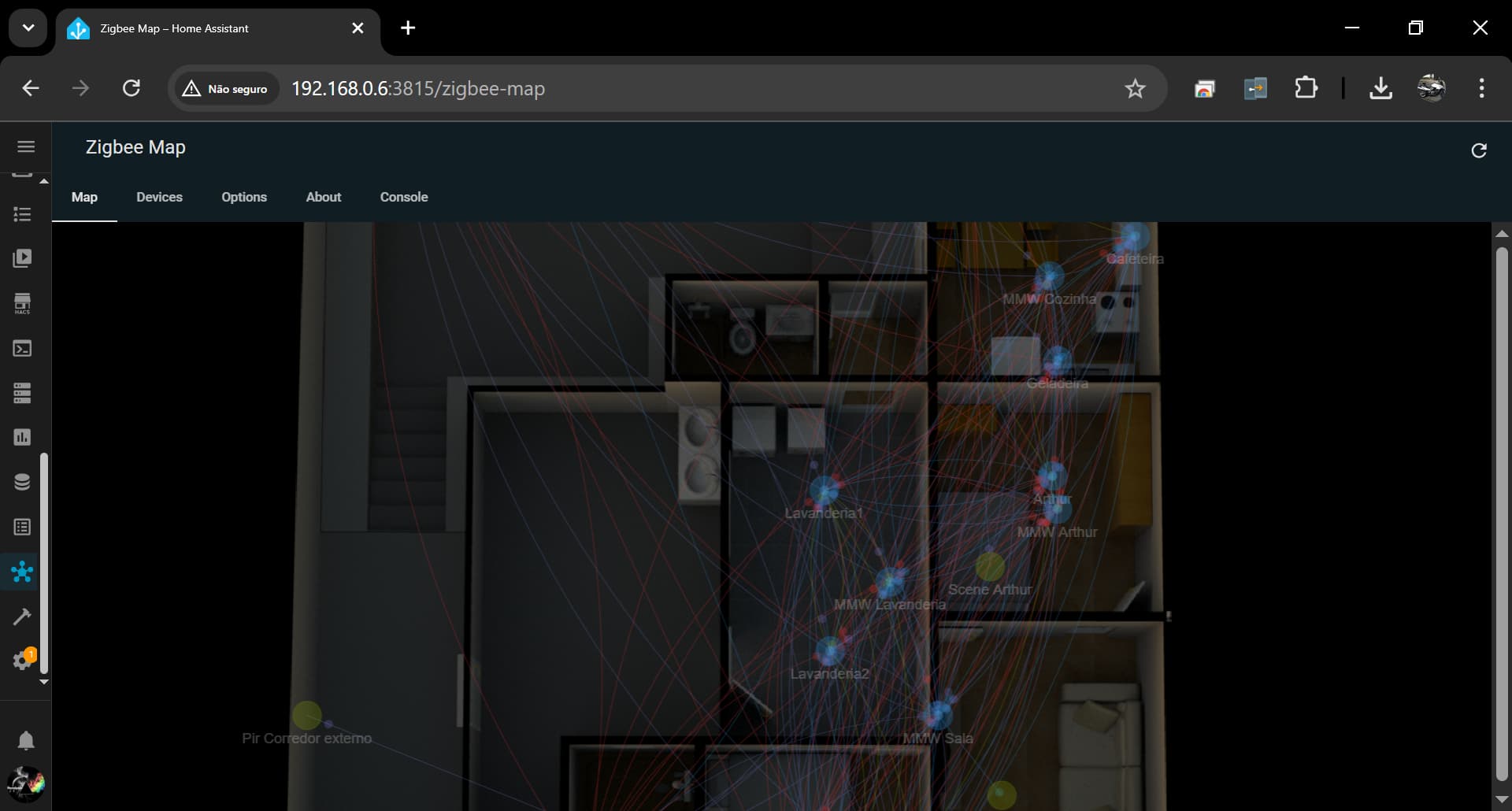

Zigbee Map - Visualize your mesh network

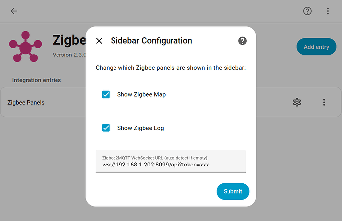

  2. If Zigbee Map is installed as a custom component/integration
    Use the configuration UI:
    1. Go to SettingsDevices & services
    2. Open the Zigbee Map integration
    3. Click the Configure icon
    4. Enter your Zigbee2MQTT WebSocket URL in the field.
      Examples:
      • ws://192.168.1.50:9001
      • ws://192.168.1.200:8099/api?token=abc123
    5. Click Submit. You don’t need to restart Home Assistant.

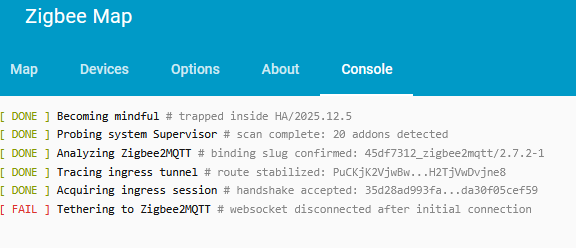

After the manual installation and configuration added in the configuration.yaml file I receive this fail, I run z2mqtt in a seperate lxc in Proxmox but I can access the frondend by adding z2mqtt proxy addon in HA and point it to the IP address with port 8099 of the z2mqtt instance without tokens.

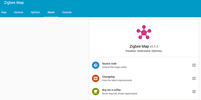

Click here if version 2.5.0 doesn't appear in the 'About' tab after updating.
  1. Go to Zigbee Map and select the About tab
  2. Clear browser or companion app cache:
    • Firefox browser:
      Press Ctrl + F5 (Linux/Windows) or Cmd + Shift + R (Mac).
    • Chrome browser:
      Press F12 (Linux/Windows) or Cmd + Option + I (Mac) to open Developer Tools. Right‑click the Reload button (the circular arrow next to the address bar). Select Empty Cache and Hard Reload.
    • Companion app:
      On your mobile device, go to SettingsCompanion appTroubleshootingReset frontend cache. Restart the app.
Have fun!
Try updating to version 2.5.0 and give it another shot.
From your logs, it looks like the Zigbee2MQTT add-on is also installed, so make sure it is fully stopped before you try it.

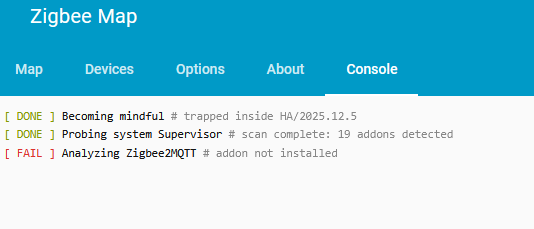

Hello Dan, I followed your tips, removed z2mqtt add-on completely from HA because I don’t use it anymore in HA as add-on but in a seperate container, cleared the cache in the browser after copying both files from your github
afbeelding
to the config/www folder and restarting HA I get this message below but the z2mqtt proxy is still installed and if I open that I see the z2mqtt frontend as it should. Weird that your app is complaining about z2mqtt not installed because I pointed your config to the seperate container with IP address. Also in the about window of your app I still see v1.1.1
