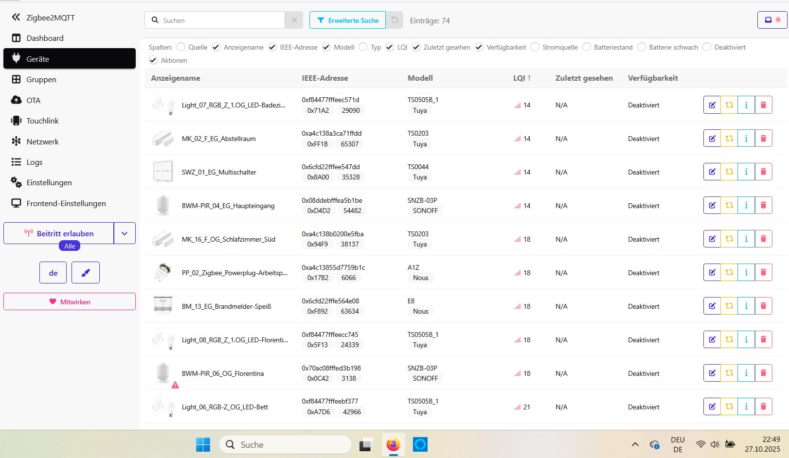

since a couple of days my Zigbee Mesh is really bad. It seems that it gets bad since the Zigbee2mqtt Software Update on the HA ( the Update with the new UI).
Actually i use a Sonoff zbdogle-P Plus, it was really good before and now lot of bad lqi.
Im not sure but i think befor the endpoints conected to more than one routers.
Actually ive 73 devices in my network and i wanted to conect 18 more, don´t know what happend.
Does anyone have idea what could be the problem now ?
Here are some Views…

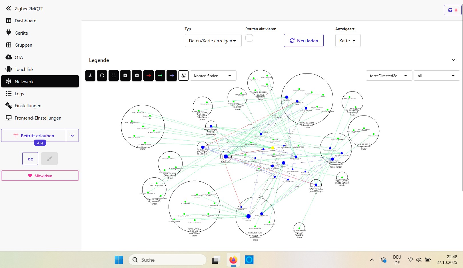

i got on every floor several powerd zigbee devices to let the endpoints conect, but i see just one conection from each endpoint to one of the bulb routers, and the endpont choose not the best router.

Are you actually experiencing issues like delays in your automations, or are you basing everything on the new map in the frontend?
Asking because I noticed the new map shows only 1 connection to my coordinator after the update (there were loads more before). However, the network itself is working perfectly fine.
No idea whether this also affects LQI values because I don’t really pay close attention, but it could be just a visual thing if everything seems to be working normally.

I use Shelly behind my Switches and normal LED Lights in my house, most of the shelly are Wifi bit i placed aware 10 Zigbee shelly in the house to gat a stable zigbee network, i also got 9 RGB-LED Controller working on zigbee to get it more stable, they are on power plug and work as router. All my end devices should have near router to connect, and when i check the map in Zigbee2mqtt i see they use often a router farer away and i got slow reactions now.
My wifi is manually manged with the channel’s, ive an asus rog router and 3 lan connected access point, all with different channels and away from the zigbee channel, ( i know zigbee channel isn’t same frequency like wifi :), i just got one neighbor and his wifi is far away, so this cant ne the reason i think, and it was working much better before the update.
And yes, i also see just one connection to my coordinator, and that router akso has just one connection to the next router, dont know why, before there were several connection between routers and between coordinator and routers, now just one…

I had a period of poor connectivity recently, as per usual (read stupid), I changed several things at once : update z2m, added and deleted several routing devices and upgraded the firmware on several routing devices. The routing devices I futzed with were a combo of 3rd reality power monitoring plugs and sonoff ZBDongle-P’s acting as routers. I’m not sure found the core of the issues (other than my stupid move to do too much at once), however to get to a solution I used the z2m ‘network’ mapping function with the ‘display type’ of ‘data’ rather than ‘graph’ and looked thru each routing device and the coordinators list of peers and parent connections and found devices that had been deleted in my changes. These had not (maybe ‘yet’) been removed from these routing devices by the removal of the devices. I ended up either removing and re adding these devices which contained these phantom routes or ‘reconfiguring’ these devices until the ‘network’ mapping with ‘data’ display showed no routing devices with phantom devices. I still have a couple 3rd reality power monitoring plugs with their currently latest firmware (v1.00.98
20250908 1722-3R) that are still randomly dropping of network, so I still have a raised eyebrow on this firmware release by 3rd reality.
In summary of my blab, check the ‘data’ display carefully, make only one significant change at a time and let the network reconfigure for multiple hours before further changes.
