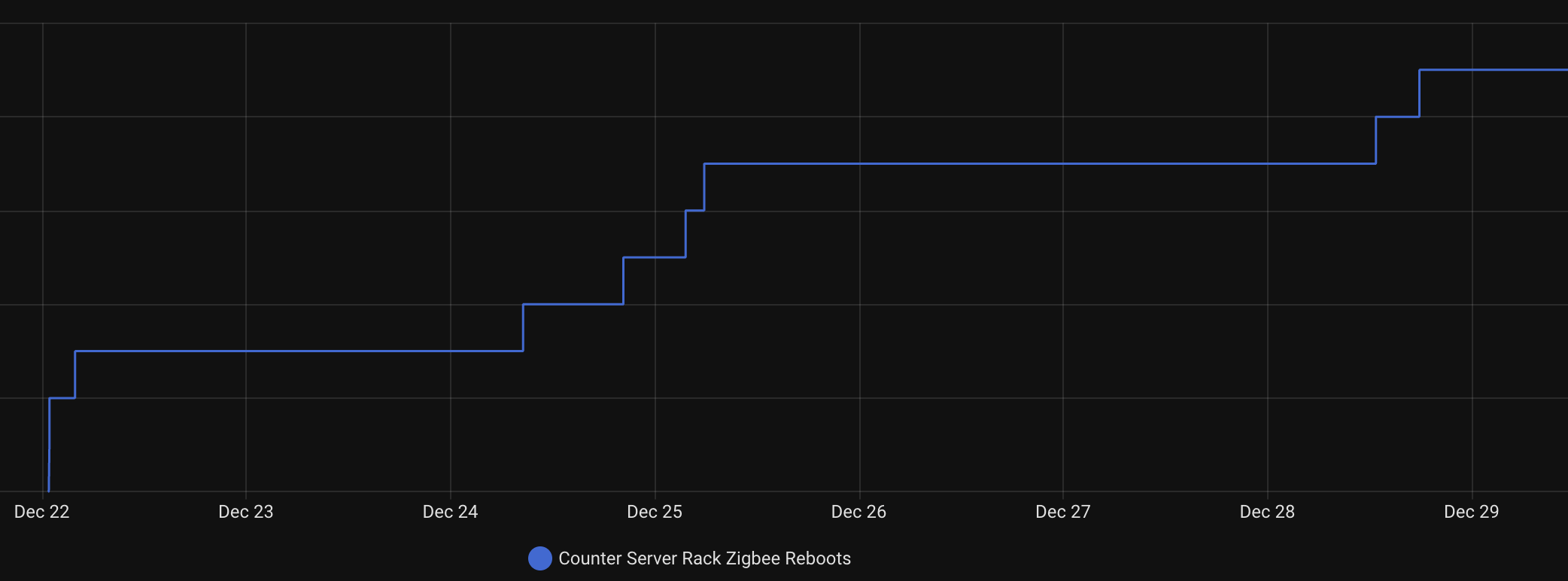

A few stats from the last 7 days on coordinator reboots…
