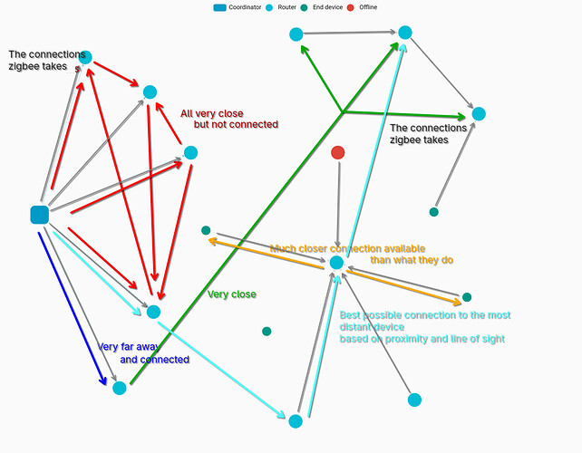

And yet, my network is barely working. Devices further away take ages to respond, if at all.
The connections the network takes make very little sense to me, it changes a bit every day but stays roughly the same for weeks now. Take a look at the screenshot I took (ONLY the grey arrows represent the connections zigbee actually makes, the rest is drawn in!):

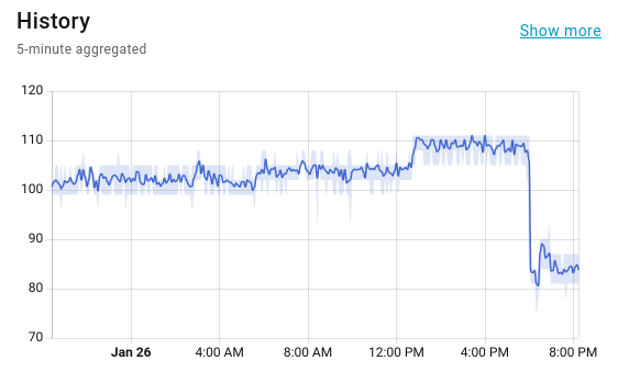

LQI is very inconsistent and devices that are far away get very bad LQI. Look at this example of a device that is relatively far away from the coordinator, but very close to other routers (which have similar graphs):
Then there are the routers that are close to the coordinator. They only get around 100, not 255 (this one is about 2m away, direct line of sight):
