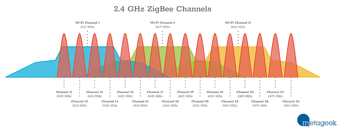

Found this graph for Zigbee vs Wifi channels:
Originally, my Zigbee network was on 14, so far tried 16, then “Smart” select in HA set it to 25, and I have also tried 26. Did not seem to make much of a difference.

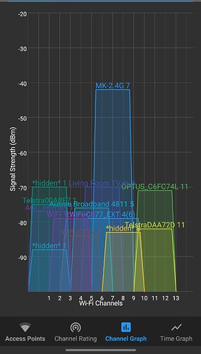

My current surroundings look like that:

Also a network channel change is a major event. Some devices don’t negotiate the change well and yih may need to rejoin some. Which one is yours. That big one in the middle?
Yeah, MK-2.4G is mine.

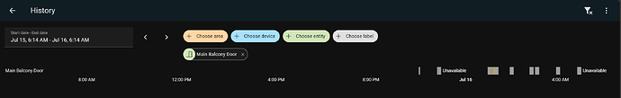

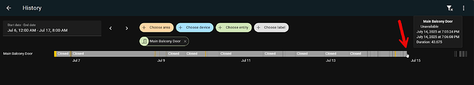

I checked the history for one of the entities for an offline device, looks like just started to happen a couple of days ago, and the other devices look very similar:
Figure: last 10 days
Figure: last 24h
