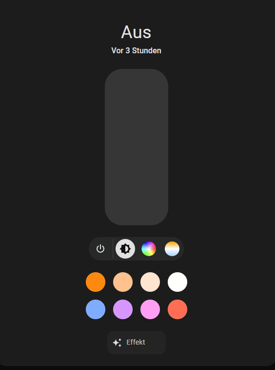

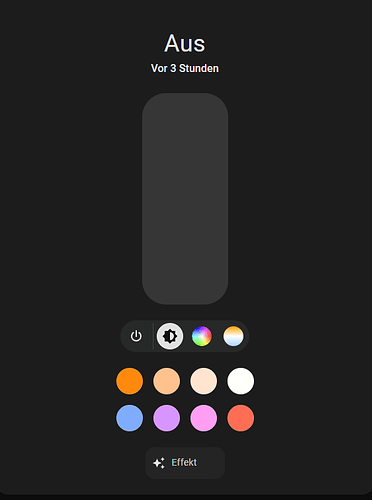

I had the same problem recently with a Shelly RGBWW Pro.
Switched to a BTF Zigbee Controller, Tuya Chip full Z2M support.
You just need a proper 24VDC power supply.
https://www.amazon.de/dp/B0B5R967HM
