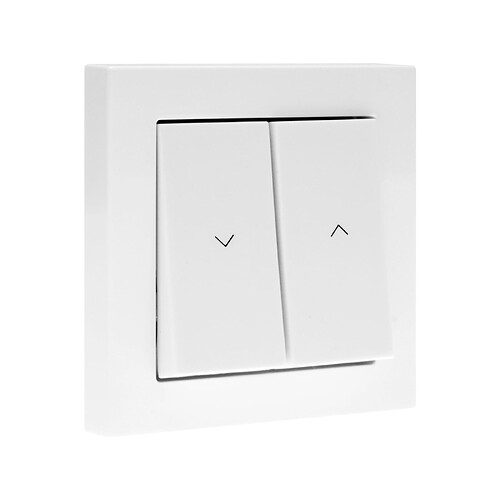

I have a few electric roller shutters which I would like to automate using these or similar zigbee modules. I just have one question: In my current setup, I have rocker type switches for up and down where they block each other so you can only press one direction or keep both open. They look similar to this:
What would happen if someone manually closes the shutter using this switch and forgets to open the switch again, so it stays in the down position? Then someone else or an automation triggers “open shutter” via zigbee. What would happen? Stay closed, open or both open+close which could harm the motor?
I doubt that on the photo is toggle switch, more likely momentary.

I can answer your question for the SONOFF MINI-ZBRBS as I just installed one, and I have the same switches as you. If you leave the switch for up or down “on” (like you normally would because you don’t want to wait for the shutter to open or close all the way), this is simply ignored later on. So if the shutter is down and the down switch is still “on” and you use HA to open the shutter, it will open and stay open. If then you want to lower it with the physical switch, you first have to switch the down switch “off” and then “on” and it will close.
