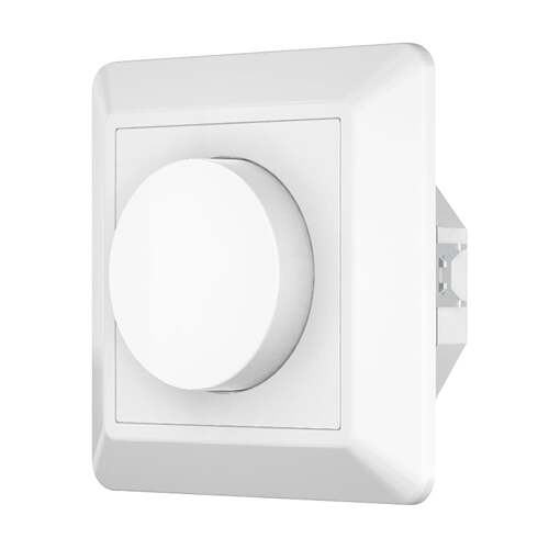

You could use a dimmer and just not connect the output of the dimmer to the bulb, but instead feed it with live.
We have two of sunricher hk-sl-rdim-a, they work fine but they do not support double, triple or even long press.

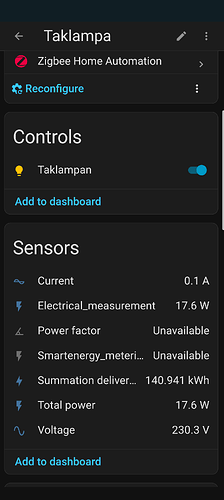

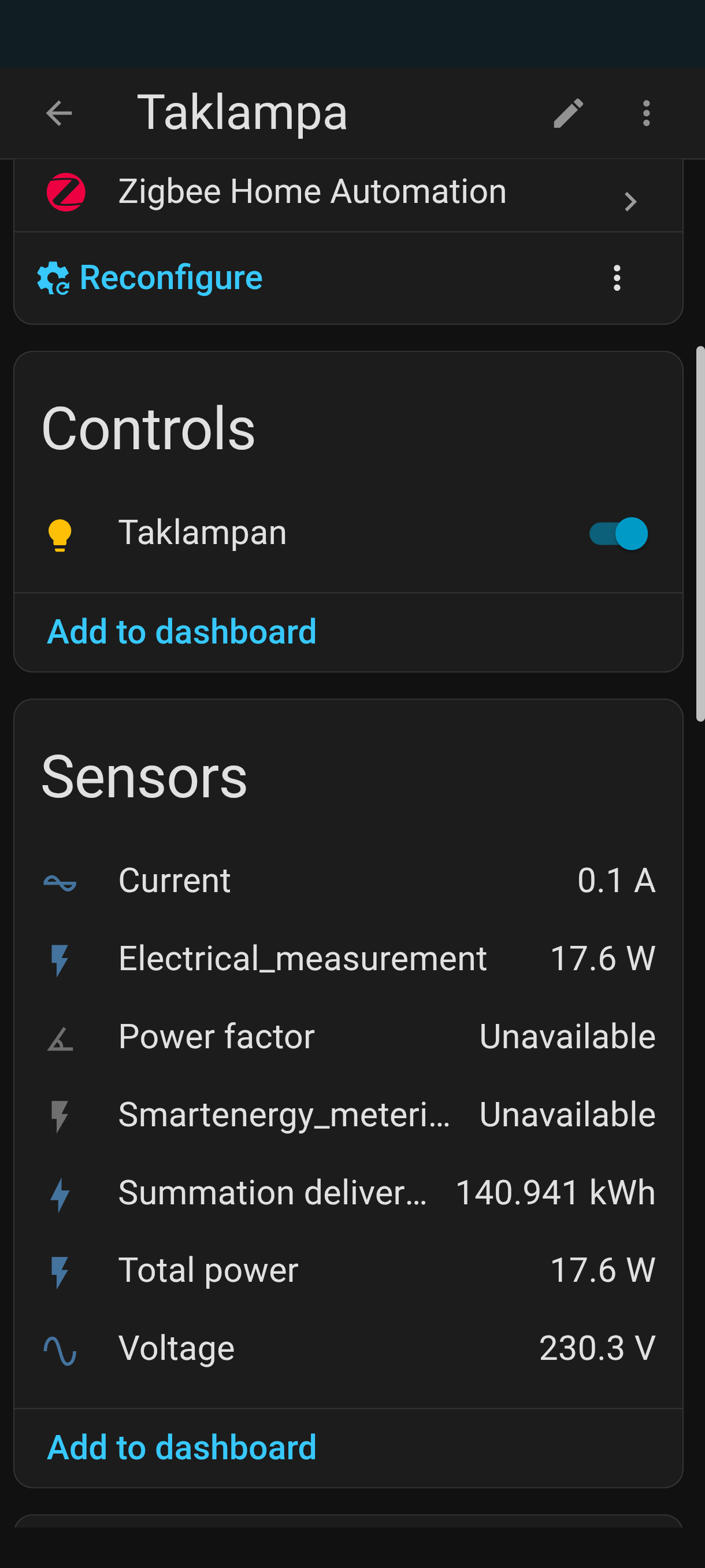

This is what I get from the device.
The light is a light entity with a brightness attribute.
No I have not connected it that way. I use the dimming to dim the lights connected to it
Yea this is pure Triac dimming probably, wouldn’t work without output since it’s not sending data of actual “dimming”.
Could be true.

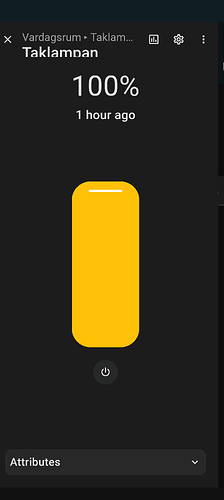

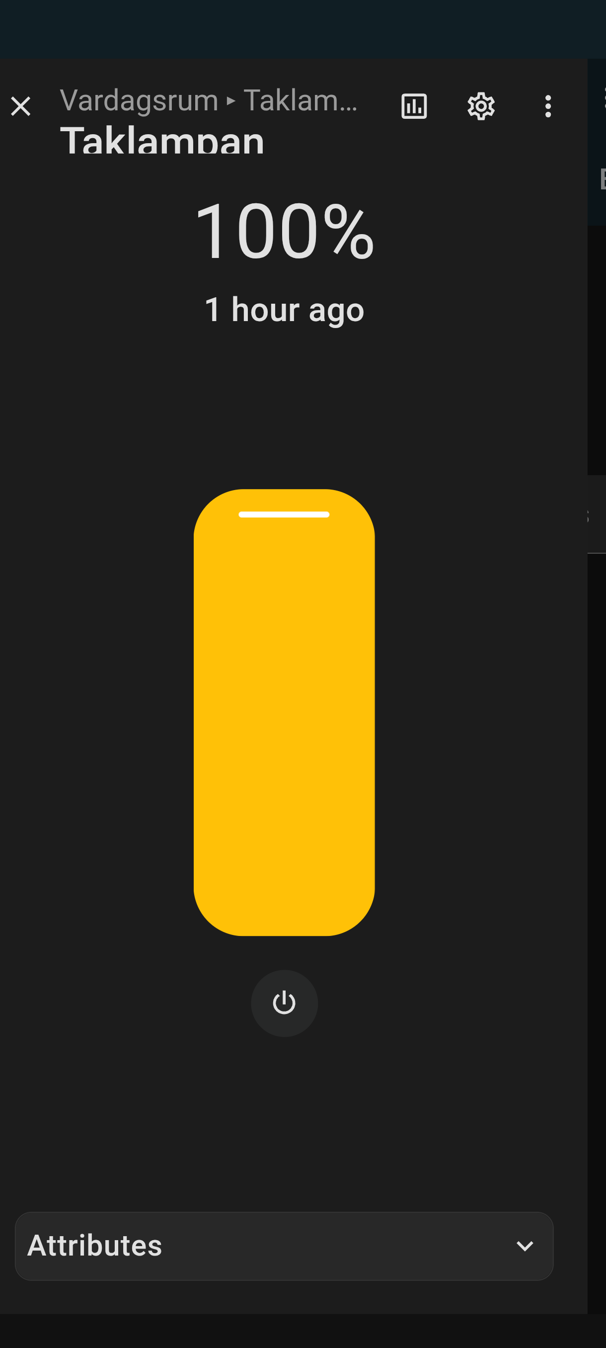

I have not tested it, just assumed the brightness attribute would change depending on how you turn the knob.
I don’t see brightness attribute?
I’m using my phone I can’t access the attributes.
But it’s there.

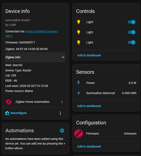

I received the aqara knob today, I plugged 230V on it and conected via ZHA to see what I get. I get 3 light switches and…thats it. No dimming or turning or double press.
Only single press which toggles all 3 light switces
And why is device Router?
Did you try and click on the actual lightbulb icons?
Or look at the developer tools for this entities?
Yes, I only have on/off option and entities are only those on the picture (3x light, power, consumption total, firmware and identify and temperature which is always 0,4C)
I’m guessing I’m gonna need to migrate to Z2M
And another thing, checking zha_event nothing shows, even single press which toggles relay and shows under activity.
And under visualization there is no “line” from knob to any other device, not even main USB dongle.
