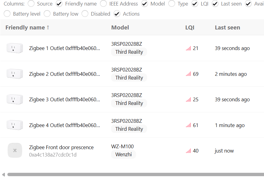

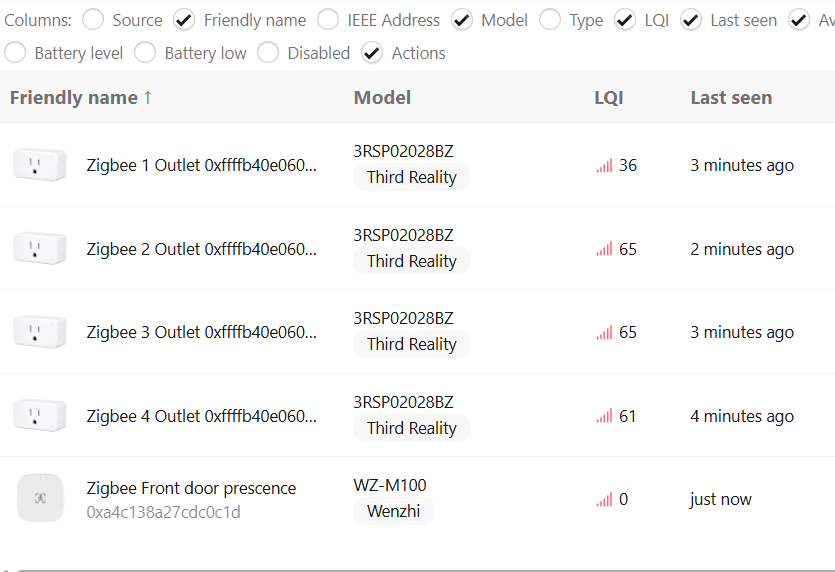

I am new to Zigbee, coming from Tuya/wifi, and I have to say (for me anyway), the range is terrible. Maybe I have something wrong in my setup, but I’m lucky to get 15 feet between devices and still the signal is weak. Here is what it looks like:
The Presence detector is maybe 8 feet from the nearest outlet and the LQI fluctuates between 0 and 30. Even an outlet in the same room as the dongle only gets to 80 max. All the other outlets are maybe 15 feet from each other, some with a wall between, and others within line of sigth.
I’m using a SZLB-6U ethernet (not USB) dongle, have switched to channel 25, and moved the dongle away from the NUC. Is there any other settings that I may have configured wrong to get such poor performance?
The Outlets are Third Reality and have good reviews for range on Amazon. Maybe I got a bad set?

Thanks for the link to the guide @Sir_Goodenough, what a great resource. Unfortunately after reading most of it, including the links, my reception still sucks.
I moved the whole NUC with Z2M dongle 35 feet away from any wifi sources. The dongle is 5 feet away from the NUC using cat 5e ethernet cable. The NUC is connected to my main router with ethernet cable. I think that eliminates interference as the source of the problem. I have a Third Reality outlet 6 feet away from the dongle and this is the result (Zigbee 4 is the closest). The presence sensor is 8 feet way but on the other side of a stone wall.
According to google, I shold be getting an LQI of near 200. I thought maybe 4 outlets/repeaters was not enough, but the dongle is now too close for that to matter. All of the outlets (4 total) are mains powered. The presence sensor is powered by USB adapter so may not repeat.

LQI numbers are almost meaningless IMO. Devices each use different calculations. LQI numbers on EZSP sticks are almost always significantly higher than ZStack. It doesn’t mean one is better, they just use different scales.
My highest is 153, my lowest is 14 both rock solid (and in the same room).
My Third reality plugs range from 40 to 91, most in the 60s-70s.
Good to know about the 915Mhz. Glad I didn’t waste my time experimenting.
Wow, that’s so helpful. I guess I don’ t have a problem after all. I only just installed them so don’t know how solid they are in operation, but your experience makes me think everything is okay. Sorry for wasting everyone’s time!
