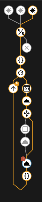

I’ve posted the automation below along with screenshots of the automation trace. At the bottom I post the errors as shown in the logs. I greatly appreciate any help.

Here is the trace diagram:
And here is the Trace Details:

Stopped because an error was encountered at August 24, 2026 at 8:57:12 PM (runtime: 5351.53 seconds)
Failed to send request: device did not respond
