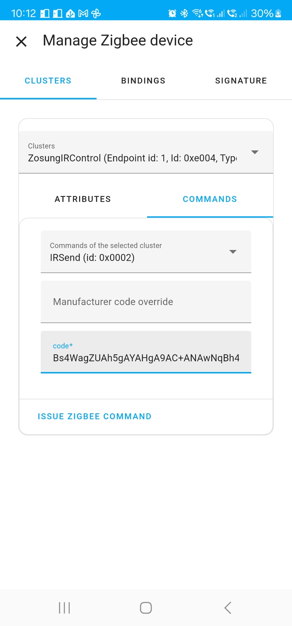

I’ve got a zigbee ir device and I’ve managed to read ir code and send it through the “manage zigbee device” menu in ZHA, but i can’t seem to make it work as an action in home assistant

It works fine from the manage device, but I’m getting an error “Failed to perform the action script/…_ir_turn_off_dumper. ‘code’”.
Tried everything I could think of…
See images attached
